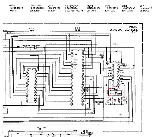

drews said:Hi Elso,
I have read on your KWAK-CLOCK-text.doc this:
"The KWAK-CLOCK will work with any crystal in the range 8 to 24.576 MHz." but Marantz cd-84 had crystal 4 MHz.
It is possible mod your Clock for work at 4MHz?
Bye
Andrea
Hi Andrea, In fact it will work with the 4MHz crystal but it will not do any good as this clock is probably for system control (U COM). You need to replace the clock feeding the decoder and/or servoproccessor 😎
Hi Elso,
I have chech now the service manual.
The cd-84 have another crystal on U-COM Servo but the frequency clock is 3,58MHz.
I don't understand your advice.
Sorry, please explain better the question because I don't understand .
Andrea

Hi, Please post a picture of the schematic with the crystal(s) involved.

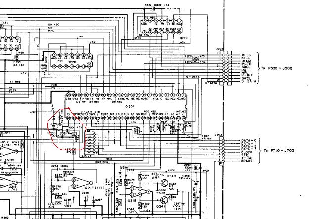

drews said:And here the other crystal on SAA7000
Bye
Andrea
The 4.2336MHz xtal at pins 7 and 8 of the SAA7000 is the one that matters. Pin 8 is the input.
Yes because it sinc. the digital-analogic conversion.
The problem is that all master clock are available only for 8-24MHz.
No
No, The KWAK-CLOCK will work perfectly with a 4MHz crystal. Even tried 2MHz.😎
