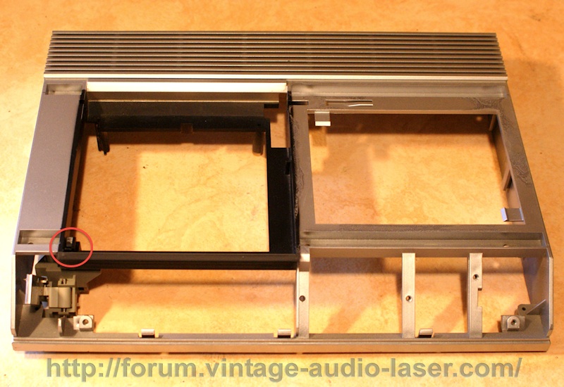

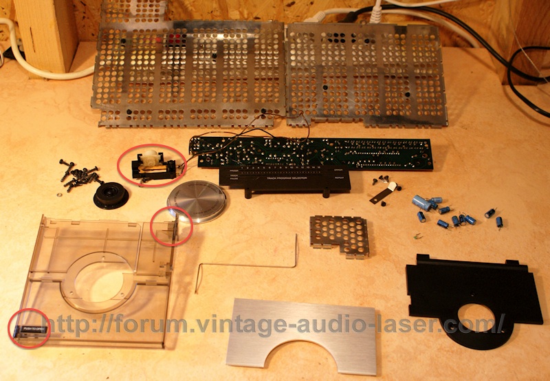

Hello Ale,
you could do me a very big favour !
I need photos of the CD 63 Lid. Especially from the lock mechanism on the front left corner
I want to rebuild those parts for a diy project and must learn how they work.
I marked the parts with red circles on the photographs following this post.
I assume the camera on a smartphone is sufficient, but you should get close.
The photos are taken from Vintage Audio Laser:
