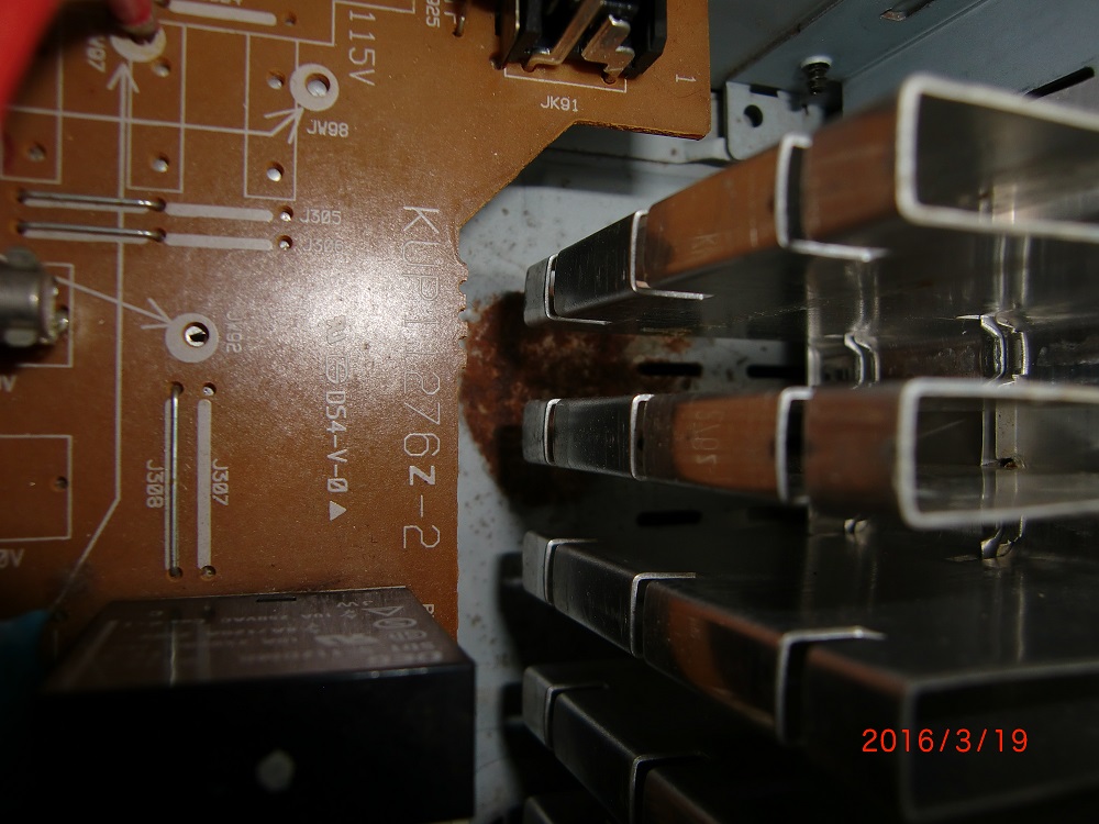

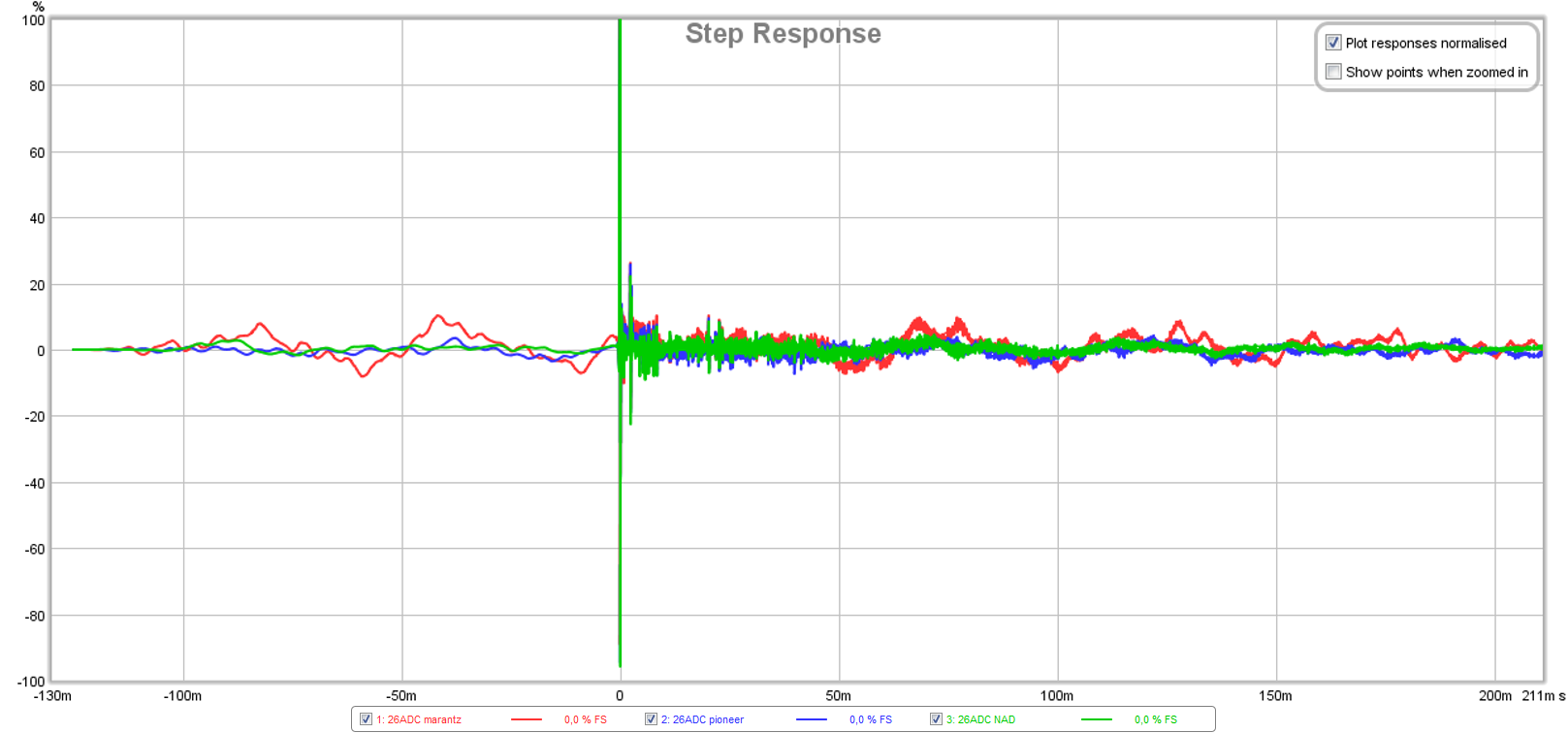

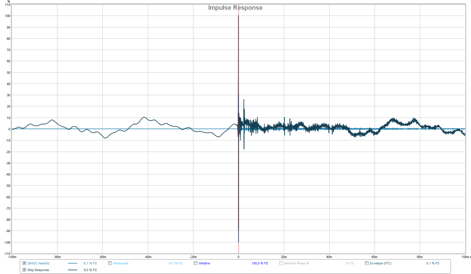

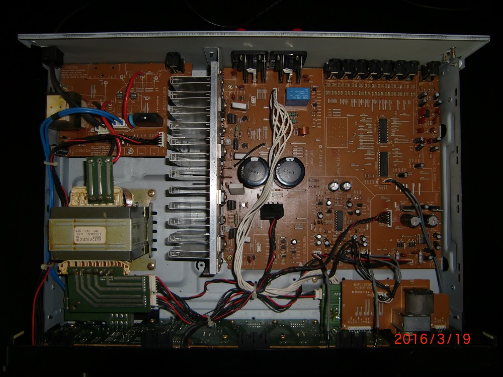

I recently bought a 2ndhand marantz PM4000 for use as a tweeter amp in my active 4-way.
After hooking it up and measuring the tweeter I noticed it sounded quite noisy and there was some weird signal in the impulse response. I measured again with an old pioneer all in one and my NAD c356bee.
I then opened up the amp and found some corrosion inside, since it's not near anything I assume something on top of the amp broke down and dripped this stuff in the amp.
Except for the corrosion under the heat sink I can't see anything out of the ordinary.
My knowledge of electronics is very limited. I do have a multimeter, soldering iron and I can measure driver impedance with my soundcard.
Is this a "sure we can talk you through some things to figure out what's wrong" or more of a "sell it again or take it to a repair man" problem?
that looks like just the frame itself, no problem there. Most any decent service guy can do a quick check on it for you. Personally, I would not even own a marantz, they are basically crap, now thats only my opinion. others swear by them and would have nothing else.

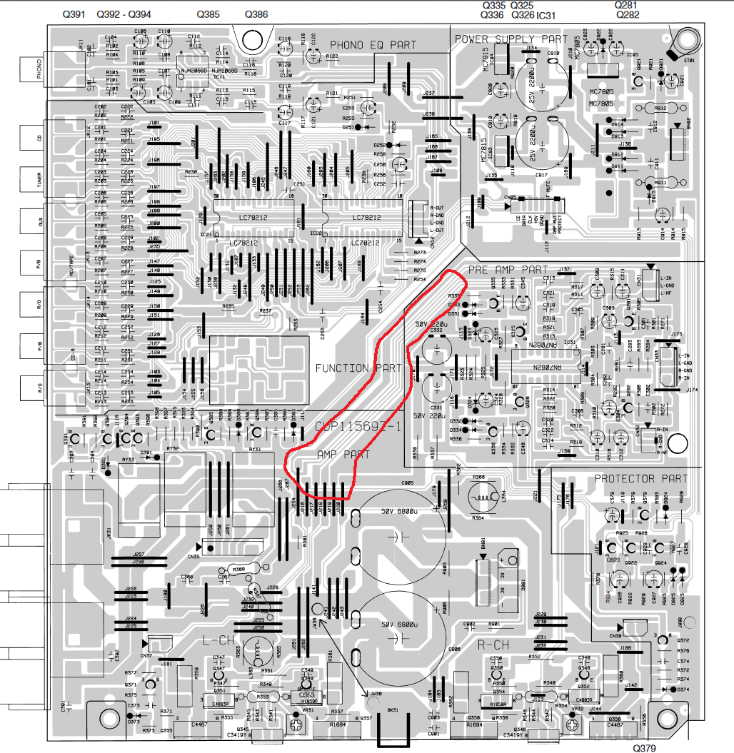

I have been looking over the service manual but for the life of me can't figure out where the amp part gets it's input from the pre-amp part...
The "preamp" part is really the voltage stage for the "current part" (drivers ,
outputs , Vbe , and heatsink).
They use the AN7062 for the input /voltage stage , run traces from preamp --->
amp part (and feedback back to the AN7062). Similar to our modern
LME49811.
OS
The manual for the amp can be found here: http://diagramasde.com/diagramas/audio/marantz_PM4400.pdf
I'm starting to see the forest through the trees. On the pre-amp part are 3 sockets, 2 of them come from the front panel with balance and tone controls. 1 of them comes straight from the volume control.
If that is the case the following traces should feed the amp part:
