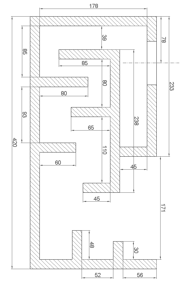

Hope this will do it.
So is it a labyrinth or a horn? Arguably both.
I have a suspicion that the rather coarse transitions from one throat cross section to the next would raise problems with the rear wavefront.
On the other hand, you could mount a driver in the mouth of the horn and run it backwards as a transmission line. An all purpose design.
