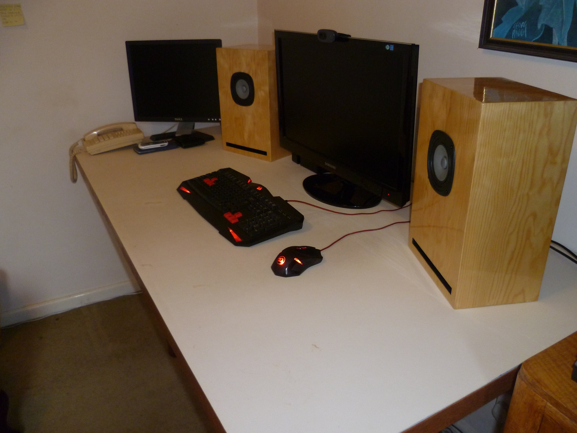

Over the past couple of weeks I have been busy constructing a pair of bass reflex desktop speakers using MarkAudio's CHN-70 driver. As soon as the polyurethane had dried, I eagerly mounted the drivers and connectors, plugged them in, and had a listen. Something was very wrong 🙁 ... I waited till the morning, leaving BBC radio 2 on at a low level, but they still sounded quite horrid when I got up the next day.
It seems these drivers have an unbelievably brash 10dB boost in the 1-5kHz range, culminating in a 12dB peak at 5.6kHz. Needless to say, this does not sound very nice at all. Interestingly, this is completely absent from the published frequency response 😕 .
I'd invested a great deal of time into this build (especially with the veneer) and wasn't going to put up with a tinny, shouty sound for all of my effort 😡 . With this in mind I came up with a passive line level equaliser to compensate for this, while also providing a little baffle step correction, along with some extension of the top end, taking into account pre-amplifer output and power amplifier input impedance. It's fairly straightforward to place this between the pre-out-power-in terminals on most integrated amplifiers.
With this in place, they sound rather good, as far as a 4" full range driver can. A stark improvement over what they sounded like previously. If you've invested your time with these drivers, then all is not lost! Give it a try 😀 .

Thanks, Chris! Pine is a very underrated veneer IMO 😀 . I did originally plan on doing them in MDF and getting the graining roller out, but raw pine just looks so good (and I had enough hide glue left over to hammer it on).
I should have probably got the router out and chamfered around the edges, but I didn't want to spend too much time on a £45 pair of drivers.
I think I'll use shellac for my next build, polyurethane has a nice tough gloss sheen, but it's a little too 'in-your face' for me. More suited to kitchen tables and floors than full-range cabinets, which should be all about finesse 🙂 .
