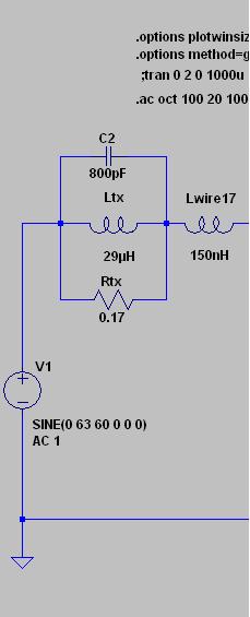

So if I am going to model this with LTSpice, should I model the transformer to be an ideal voltage source in series with the parallel of H=28.8uH (44.8uH for the other), R=0.15 (or 0.225R?) and C=? (to be worked out)? Please see an illustration in the attached picture.

Looking from the power supply side, I presume the circuit sees the transformer's secondary leakage inductance, leakage capacitance and winding resistance.
For a good approximation only, can we ignore other parameters hence saving the efforts of modelling the primary side? Would this approximation be good enough to use to design a PSU?
If so, can I model the transformer as an ideal voltage source in series with the parallels of leakage inductance, leakage capacitance and winding resistance? or the inductance and resistance are in series, then in parallel with the capacitance?
Real transformers are usually modelled as ideal transformers with added parasitics, such as leakage inductance and capacitance.
A transformer is not a voltage source. Ultimately it is a pair of coupled inductors, so that is where you have to start from.
You can set it up as a voltage dependent current source, then add the parasitic elements.

I read "Calculating Optimum Snubbers" by Jim Hagerman, and when calculating the snubber he only used the leakage inductance and the interwinding capacitance as a lumped capacitor in parallel with the inductance. If that works it means we don't need to be concerned with Lpsopen, Lpsshort, etc.
So I am wondering if I can simply model the transformer as an ideal voltage source in series with the "transformer secondary", the later is simply modeled as a lumped interwinding capacitance, interwinding resistance and leakage inductance, with an even more simplied model of having the 3 in parallel, as I gave in the picture of my original post.
Would it work?

The interesting thing is I got exactly the same results as you and Hagerman wrote on the paper in my simulations using the equivalent circuit given by Hagerman.
But wait a minute. Hagerman's equivalent circuit has the Ct (transformer secondary winding capacitance) connecting the secondary winding to ground, but has the inductance and resistance in series with the circuit, hence the corresponding simulation results. I think it is not entirely accurate because in that case the capacitance shunts noise to ground but in real situation the capacitance can actually pass (bypass the resistance and inductance) high frequency noise (from the mains coupled to the secondary) from the secondary to the circuit! So I thought I would give it a try to put the capacitance in series.
Now if I put the leakage inductance, winding capacitance and resistance in parallel and then connect in series with the circuit as I guess they can be, I don't find any resonances like what I previously simulated!!! I find a bump below 100Hz that requires a 0.05R resistor to fix.
So this is still about finding the correct equivalent circuit to model the transformer parasitics to make it useful in simulating a power supply.

I think the hardest bit is to model the power supply correctly.
The transformer secondary winding is a lumped element of inductance, resistance and capacitance, while we tried to simplify it to 3 individual components. I guess that may be where I have gone wrong.
Other things have not been modeled, such as the power line input impedance, primary winding LCR, etc. I use a voltage source plus the inductance, resistance and capacitance of the transformer secondary, that may over simplify the picture.
But I must come up with a simple (or simplified) but effective model to come up with some good approximates.
