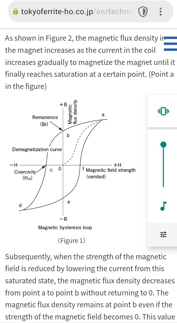

Problem is that you have a very nonlinear BH curve
First the "normal" case:
Ferrite is bought unmagnetized, so it starts at "0"
Then magnetizer coil applies a huge magnetizing field to it (that's why machines are beasts) reaching point "a"
Old field coil speakers (which were VERY good) just stay there.
Problem being that you must feed magnetizing coil continuously.
With permanent magnets, you remove magnetizing current, magnetic field lowers to point "b" but a lot remains (that's why it's called "remanence")
Notice "b" is lower than "a" but in any case it's usable.
Not needing to feed a field coil all the time is good 🙂
"Molested" magnet (disassembled/reassembled while magnetized):
Magnetic field will again move just because of the "mechanical" movement: being inside the speaker magnetic system and outside (separating ferrite ring from plate, removing polepiece from inside the gap) is not the same as just leaving it there.
It will still move following the same kind of curve but now starting at the "b" level.
After reassembly it will reach a new level, which will be lower than "b", that means it will lose at least some strength.
How much?
It depends on material.
Ferrites are quite "hard" so a certain %
Measurable and even noticeable by ear if tested side by side with another same type.
Alnico is trashed, it is magnetically softer, suffers even under "normal" use in certain circumstances, that's why remagging services are offered.
Never used NEO , they are very hard, not sure how would I even disassemble it, let alone reassemble.

In a nutshell:
- when you vary magnetic field, it will follow the "S" or "Sigma" shaped curve.
- Unless you remagnetize it with a machine, on each "movement" it will return to a lower value than it had before
- So much so, that demagnetizers work that way: they apply an oscillating field, which is always decreasing.

In a nutshell:
On each inversion it returns to a lower and lower value, until it returns to "0"
As for metal. Yes, it should be as low in Carbon as is possible. Carbon is the enemy of an efficient magnetic motor. Silicon Iron is good too. Iron is hard to find and terrible to work with as a machinist. Like hard sticky butter.
