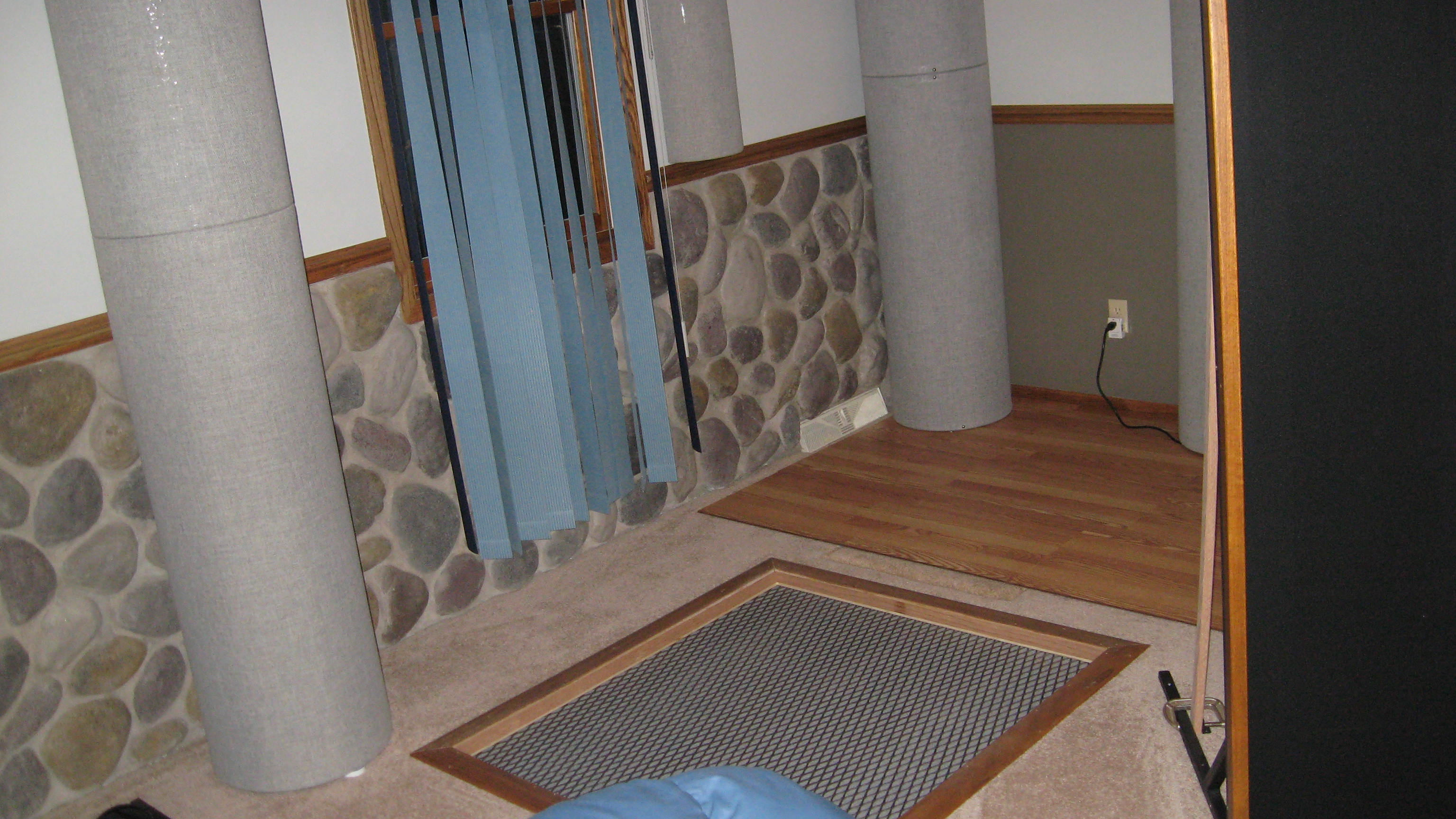

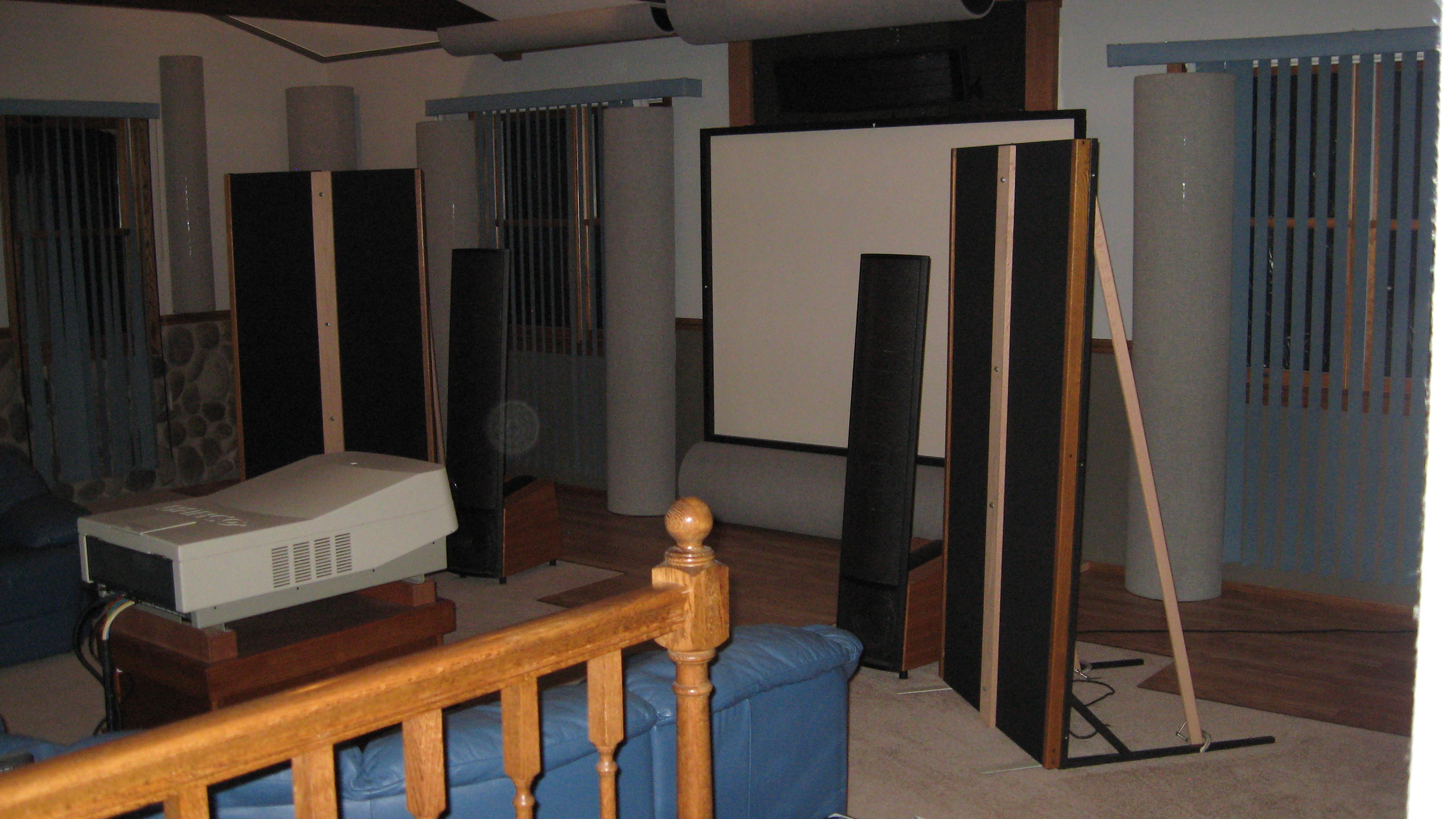

Magneplanar Tympani IV bass panels
I use Magneplanar Tympani IV bass panels which extend to below 30 hz along side of Martin Logan Summit electrostatics. Also an Eminent Technology TRW-17 rotary subwoofer which goes down to below 1 hz. This combination is awesome!!!!! The Maggies are modified (xover network and panels have been beefed up and bolted together and to the floor. The room is completely treated with 36 ASC tube traps.
If you want great bass, this works.
