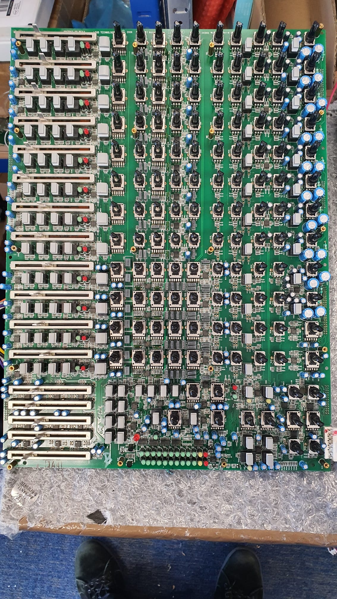

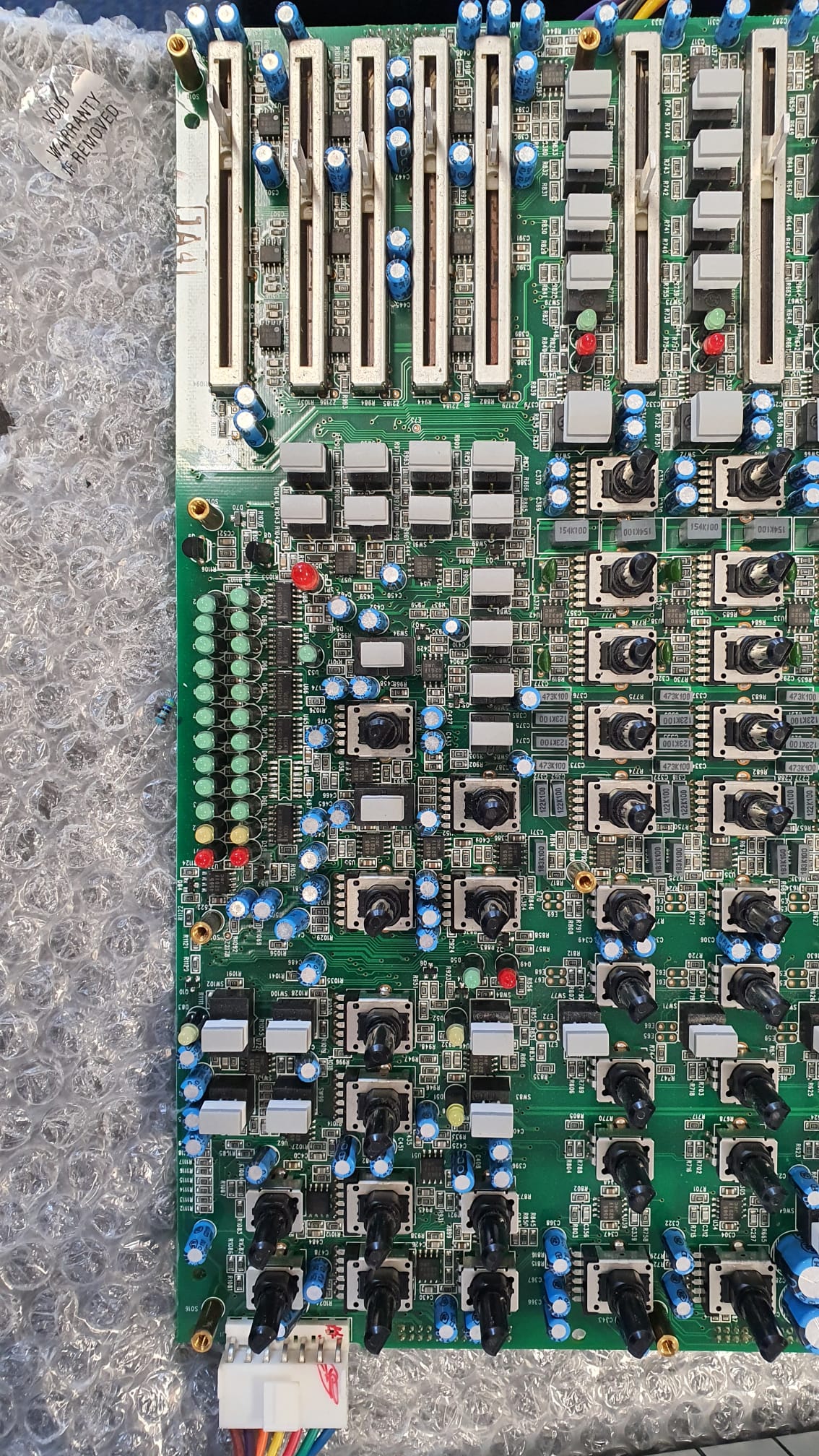

I actually have the unit completely stripped down with the main boards silk screening completely visible but like I mention, there isn't a U1727 I can see. I also understand what the main meters are but I don't understand what you mean by "pegged or dead2? I've attached a picture of the main board I have. You will see I have removed one of the LM339 IC's. It looked like it had some heat damage compared to the others so I remove this to see if that helped (which it didn't).

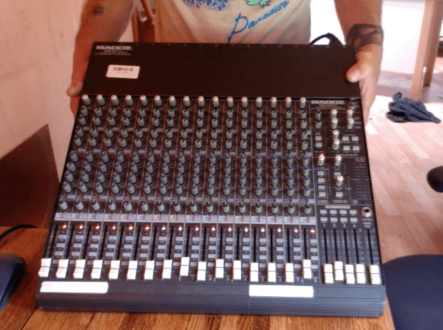

hey folks, having the same problem here with my Mackie 1604 vzl pro mixer. All "OL/Mute" lites are on solid, no mute button engaged, "Rude Solo" flashes constantly with no sound through anything and no solo buttons engaged. I can start a new thread if need be, but have you found a solution? Is it the infamous U1727??
yes I have a can of deoxit and will try cleaning, but it seems like there is a more systemic problem. No lights or switches function other than the solid mute buttons and the incessantly flashing "Rude Solo" light. No sound through the board and the meters are dead. Solo buttons and mute buttons do nothing when pushed. You can see in the picture all "OL" mute lights are on and nothing changes regardless of buttons pushed. The funny thing is the buttons worked when I pulled it out of the box and then stopped working. Worried something blew
