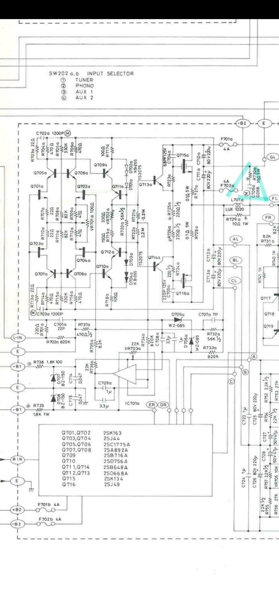

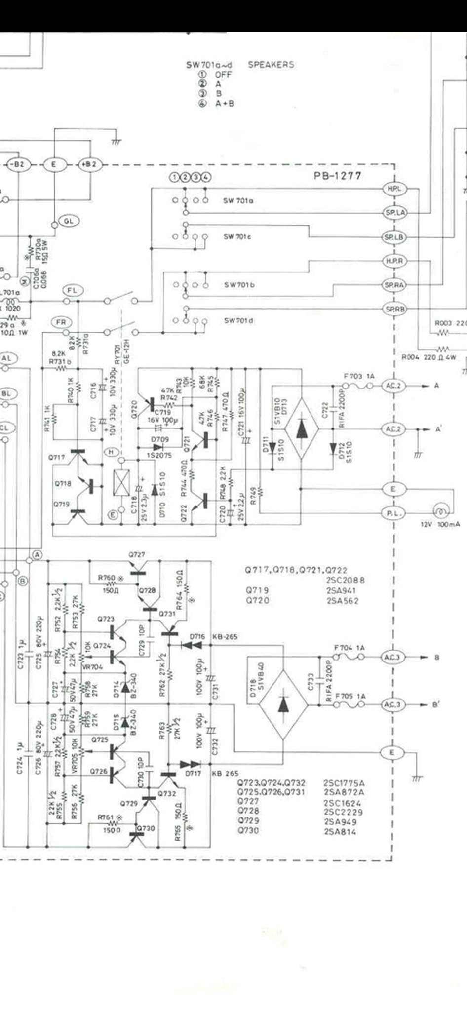

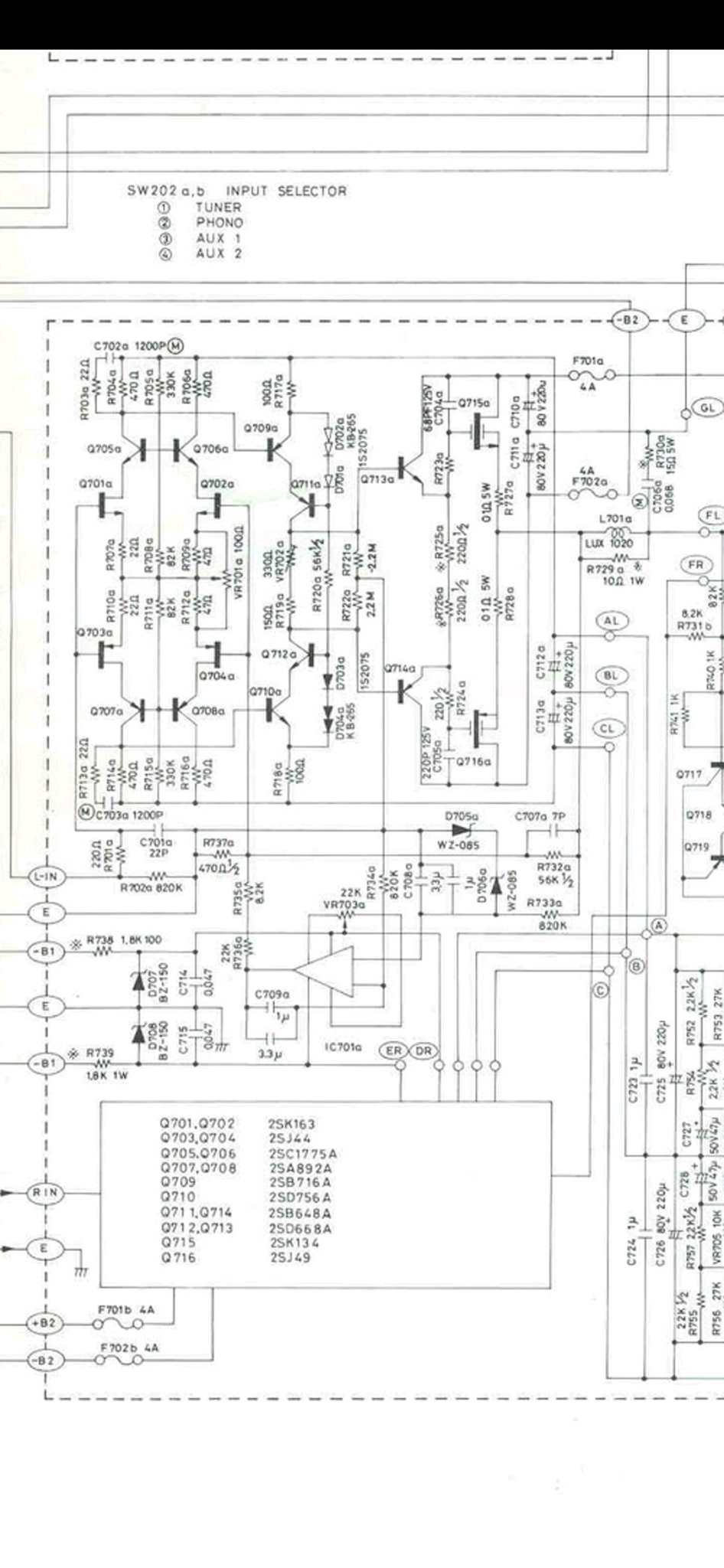

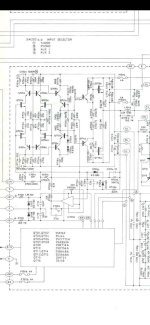

I'm making the adjustments to finish setting this amp up and want to check my understanding of the procedures before I do (see attached photo for the Luxman procedure)
Firstly I wanted to check the idle current so I pulled the fuses and connected my meter across the fuse holders and switched on, set this on both channels to 200ma as its on a bulb limiter, is this about right?
Now DC offset adjust it says to earth the test point to whichever channel I'm adjusting, I take it just clip a lead between TP and Chassis? Then follow procedure?
And the AVR adjustment, cannot find the test points what am I adjusting here?

On an unrelated note on one of the channels R730 15r 5w gets around 10-20 degrees warmer than the other, what's that resistor doing and what could cause that?
Looks like its supposed to be a zobel network to help with stability. You might check C706 to see if its shorted. Also might want to look at the output with a scope to see if any oscillation is present.

You didn't say whether you have a scope. Confirm that there's 0V DC across R730--- any DC at all would imply leakage through C706 which would have to be quite large to cause noticeable dissipation in the Zobel. Far more likely is oscillation at high frequency. Would be great to have a scope.

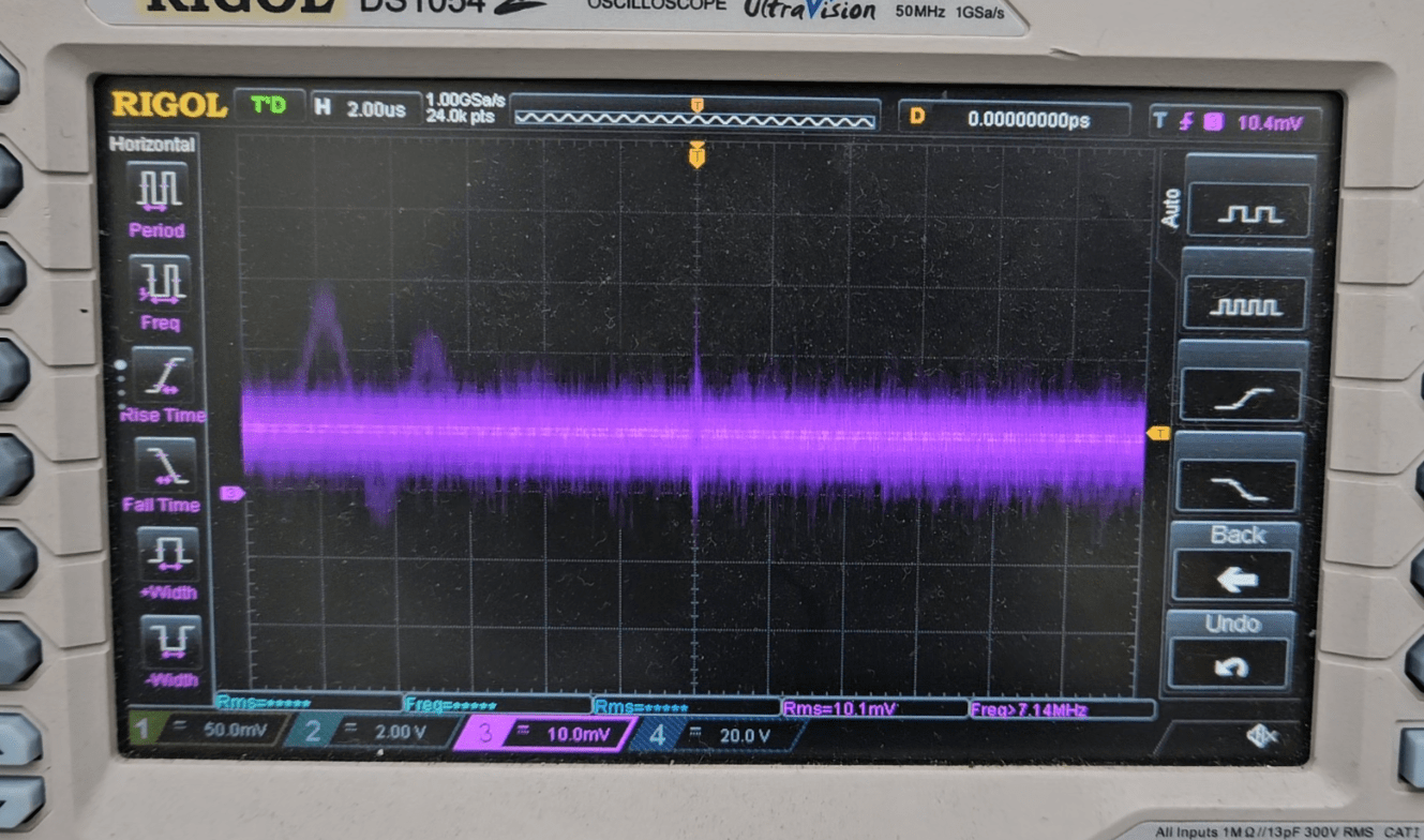

Scoped the output on both channels, first video is the cooler zobel channel second the warmer one, tested no input or load connected
Looks like there may be some oscillation bursts on the lower scope video. Maybe try some of the following ideas to get a better pic of what is going on.
Connect the scope ground to the amp, then touch the probe tip to the ground. Whatever you see is some combination of ground noise and ambient EMI/RFI. To further investigate, disconnect the probe ground from the amp. Once again touch the probe tip to the probe ground. What do you see? Its whatever the ground lead is picking up as a small loop antenna. Moving the probe-and-ground-wire around may pick different noise and or signals, just as aiming any antenna may help pick up some signals better.
Also, maybe worth trying to get a stable scope shot of that garbage. To do that set the horizontal mode to Normal, then adjust the trigger level until it just barely triggers on the highest noise peak. Then set it to single sweep and see if you can capture details of the noise peak.

Here is one frame of the 2nd video:
