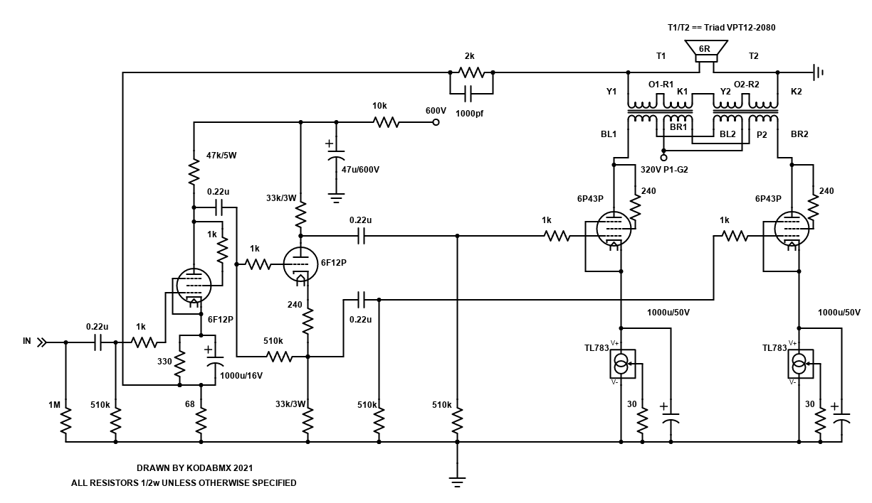

I'm thinking of basically copying one of kodabmx's PP amp designs using 6F12P, even though he uses 220VAC transformers as OPTs. The B+ is likely going to be down around 300V, so I will need a driver stage that can swing +/-30V from 1V input signal with a low plate voltage. Perhaps a 12AT7 LTP can pull that off, or maybe I'll need to look at using a pentode input stage into a cathodyne phase splitter. Or... A paralleled 12AX7 as voltage amp into a MOSFET 'source-o-dyne'?

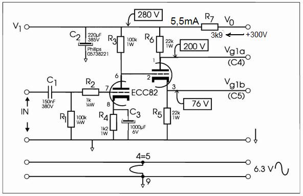

6F12P will work. This schematic will do the trick - just run it from 300V instead and perhaps reduce 10k to 2k (3 watt)
Here's my implementation of 6F12P and 6P43P as in the Little Miracle amp.
The 6P43P cathodes are around 30V and I used 1uF coupling caps instead of 0.22u from 6F12P to 6P43P.

Koda, have you measured the current through the pair of 6P43Ps in you circuit? I wondered if the primaries on rongon’s Z565s can handle that much current. I tried to find a specification for the current capability of a Z565, but have come up empty so far.6F12P will work. This schematic will do the trick - just run it from 300V instead and perhaps reduce 10k to 2k (3 watt)

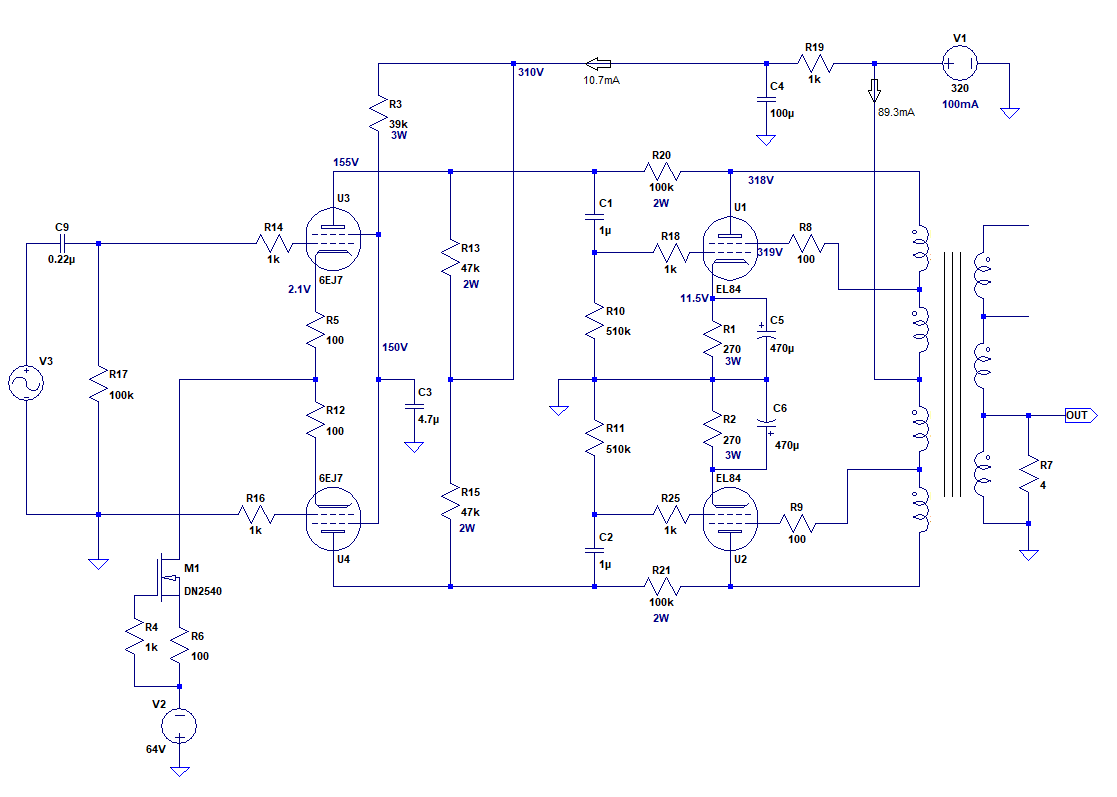

Perhaps this is my chance to finally try that 'Schade' feedback everyone was so excited about 10 years ago. I was thinking of something like this:
I've been curious to hear what this kind of circuit sounds like. It should get a reasonably clean 10W per channel, which would be good enough.
Can that Dynaco power transformer deliver 200mA? I'm not so sure. I have other transformers I could throw at this...
It might be worthwhile changing the output stage to fixed bias, or perhaps the EFB boards can be shoehorned into this circuit.

I'm not worried about really close impedance matching, just the very general idea that one gets lower THD and better damping if the load is lighter on the amplifying device(s). With the OPT in the mix, if I put a 4 ohm speaker on the 8 ohm secondary tap, and the nominal impedance ratio of the OPT is 8k:8, then I've changed the transformer's nominal impedance ratio to 4k:4.
On paper, 4k:4 doesn't look great for PP EL84s. but it's nearly ideal for PP EL86s.
That's as far as I went in my thinking about it. Am I overthinking it even on that level?
One reason I was thinking of going the 'Schade' feedback route was that the OPT is not in the feedback loop, and the NFB reduces the plate resistance of the output tubes by quite a bit. So the impedance ratio of primary:secondary becomes even less of an issue. That, and I'm really curious to hear what this topology sounds like....
