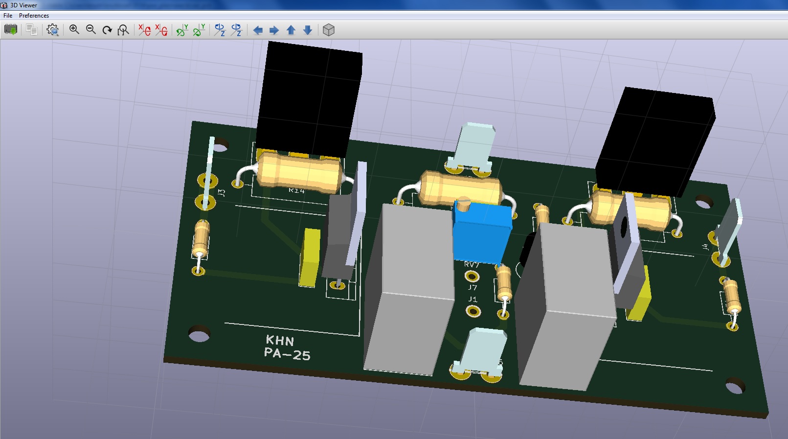

Having used Cadence Orcad earlier, I have completed a design with Kicad finding it doing a similar job for free, with satisfaction. Attached is a screendump of the 3D-viewer.
Nice Job!
