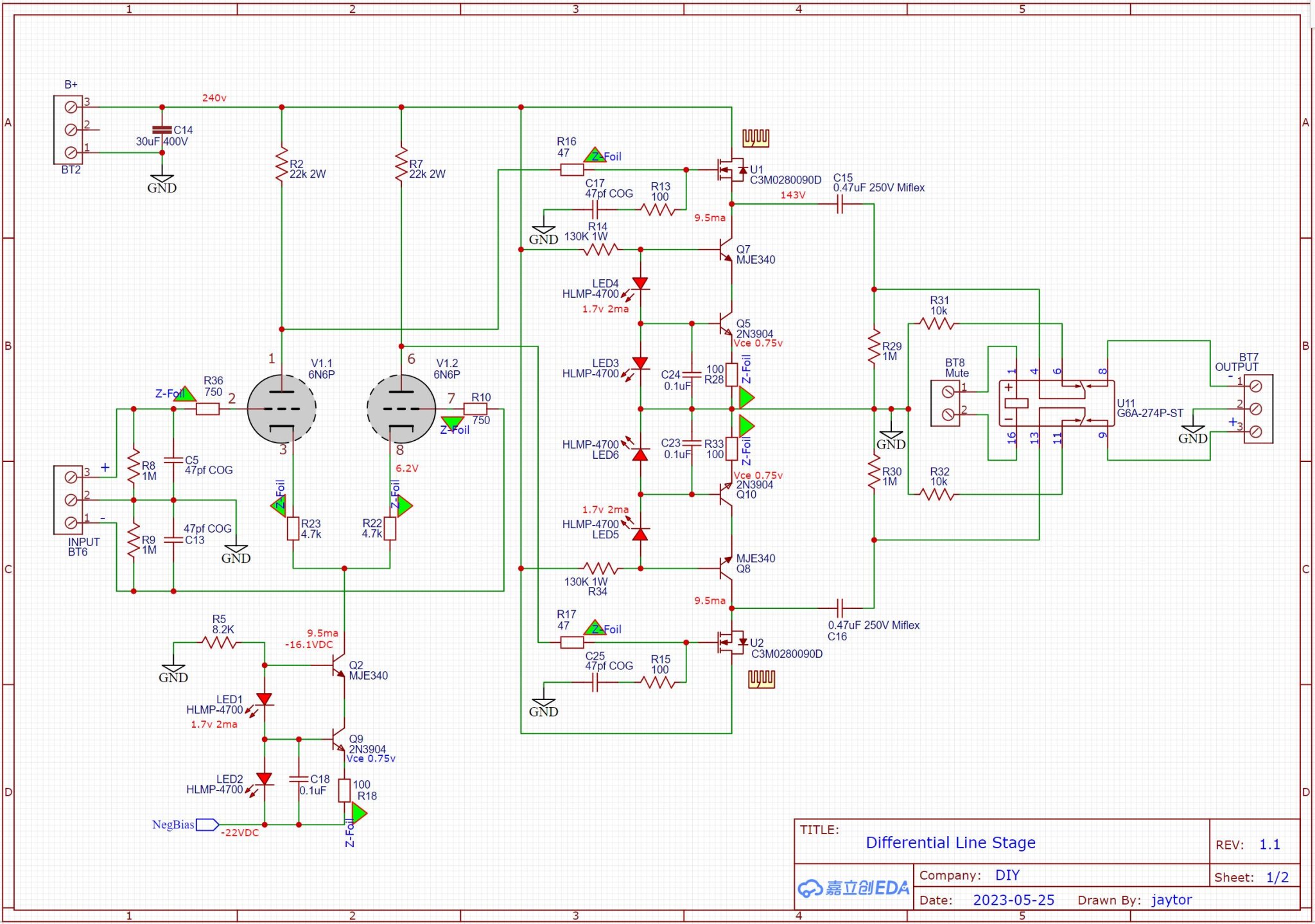

I am working on a fairly simple balanced line stage that will consist of a LTP driving a balanced source follower output stage. The LTP will use a discrete SS CCS in its tail and will be driven from a balanced source. My B+ is from a Maida regulator with about 250V output, and a regulated 6.3V DC heater supply. I could voltage double if the heater current is low enough. I also have a -20VDC low current regulated supply which I am planning to use for the CCS connection.
I am looking for a dual triode recommendation that is not too finicky (I'm a relative novice when it comes to tube circuit design) that will produce clean output with modest gain (2-3x optimal) and no global feedback. I was thinking of a 6SN7 or 12AU7.
I was also thinking I'd use some cathode degeneration to improve linearity, reduce the gain, and potentially to adjust balance (with a trim pot).

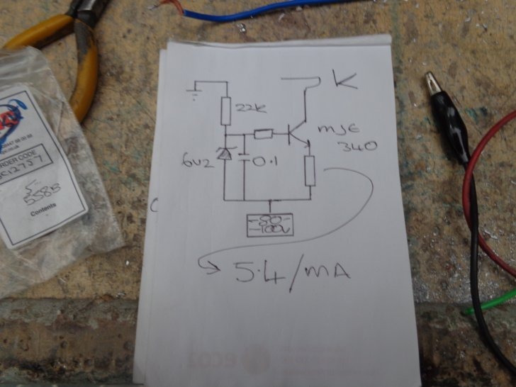

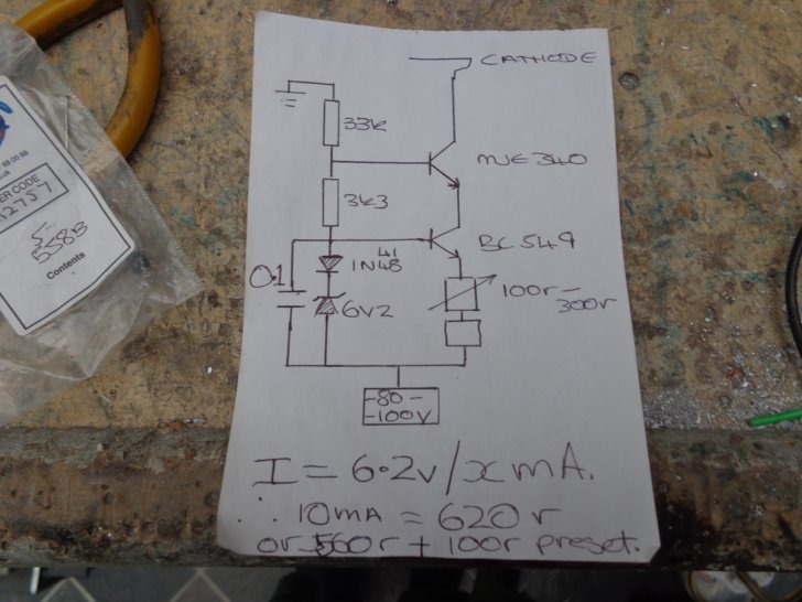

The ECC82, 12BH7A, 6CG7, 6SN7 all make decent LTP's. I usually use 47k anode R's with the CCS set to around 4mA ish (8mA total) Vk = 7 to 8v. I've attached a couple of CCS circuits I use though they might need tweaking at you have a lower negative rail.

I prefer using a 6V2 zener because it gives a higher V ref than a LED so I can use a 500r Piher preset in order to make Ik adjustable. If you really want even better regulation use a CCS into the LED or zener. Sorry, winding up all the "sand" haters out there : ) 2N3904 Yep, any old Q will do though Morgan Jones in his book say s a Q with a higher hfe = a higher Z. Having said that I've used all sorts inc BD139's, 2N2907A's (in active loads), BC550;s, MPSA42/43 and of course the MJE340. doesn't seem to matter much.@Diabolical Artificer - your second CCS circuit is very similar to what I was planning, but I'm going to use LEDs for voltage references, and was looking at a 2N3904 for the lower transistor.
One thing I have found using a CCS/LTP combo is that the two Va differ by about 10v DC, this is less with a R as the tail, something to take into account if anything is direct coupled. One useful aspect of using a resistor in the tail is less gain, which may be desirable as others have noted.

I was shooting for a voltage gain of about 3x, but after looking at one of the amp projects I am working on, a bit higher gain would work well. My current primary amp has an balanced input impedance of 10K with 7M cables, so it needs a reasonable amount of drive. With my current amps (and planned projects), a maximum output voltage of 8V would suffice, but having a little more headroom wouldn't be bad.
I'm currently thinking of trying the 6N6P. I've got a bunch of these in my limited tube stash and it looks like it might work reasonable well. Attached is my current schematic. I'd appreciate any critique.
First of all, you really don't need a high voltage MJE340 as Q2. Then, what do you intend with R22 and R23? To reduce gain, configuring each branch as an inverted amplifier with NFB from the output to the related input grid might be preferable, if the source impedance allows it.

Jaytor,
Your Post # 1 said: "I am working on a fairly simple balanced line stage".
I never thought the intent of the design question was to be able to produce a preamp that is this complex. Wow!
Make sure that all thse solid state devices quiescent operating points do not drift more than the tubes quescent operating points drift . . .
as the preamp warms up, and as the ambient temperatures change . . . winter to summer.
Is this for a commercially produced product?
If not, I have to ask what the rest of your home system components are . . .
Turntable, tone arm, moving coil cartridge, MC transformer, high end CD player, power amp mono-blocks, loudspeakers, room treatments, etc.
