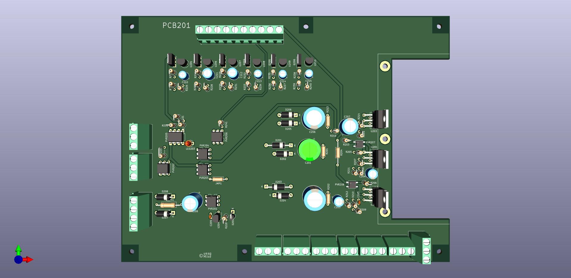

My current project has a controller board with three voltage regulators, two LT1963's and one LT3015 negative regulator. The "problem" which isn't a real problem is that both 1963 positive regulators are not completely shutting down when the shutdown pin is low. I get about 275 mV @ 170 uA instead of the 0 volts and "less than one microamp" it is supposed to show. Now I know that nothing will run on voltage that low but it seems weird that it doesn't go to zero volts like the LT3015 does. Is that just a quirk of the LT1963?
Here's that part of the PCB:
Any thoughts?

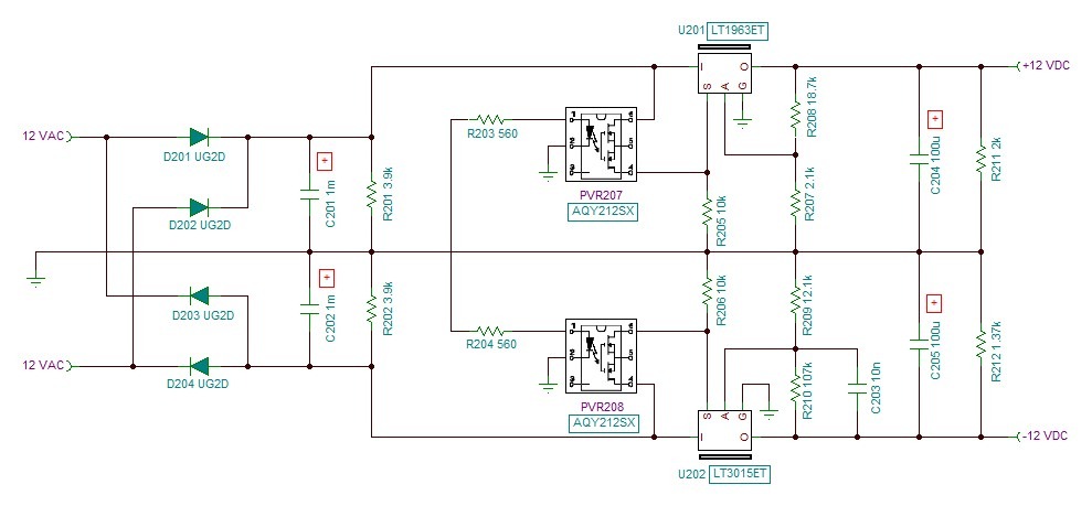

Yes that's odd. Have you tried to jumper R205 directly to the adj pin gnd?
Are the grounds of the adj pin and R205 separated by a piece of track that carries output current?
Another consideration is that there's some ripple going trough the opto even when off; is the residual output pure DC or rectified ripple?
Maybe scope the shutdown pin (and output) when off.

If Jan's recommended oscilloscope test reveals 0.000V across R205 at all horizontal sweep settings from 20 msec/div to 20 nsec/div, with the scope ground clip attached to the LT1963's G pin,
and if shorting the LT1963's S pin straight to its G pin doesn't let the +12V rail drop to 0.000V { bypassing Jan's hypothesis of ground-isnt-ground },
then you've either got a bad LT1963 chip, or there is some other circuit entity sourcing current into the +12V rail.
If you don't want to spend the money to replace the LT1963 until last, when it's unequivocally proven to be the problem, then you can pursue tactics to find "some other entity sourcing current into the +12V rail". Such as looking at the schematics of everything connected to the +12V rail and finding all components connected to +12V. Then probe those components and their nearby neighbors, looking for voltages ABOVE the +12V rail voltage which post #1 says is +0.275 volts. Signal XYZ is above the +12V rail? Then XYZ is pulling up the +12V rail.
...if shorting the LT1963's S pin straight to its G pin doesn't let the +12V rail drop to 0.000V { bypassing Jan's hypothesis of ground-isnt-ground }
Please explain: does that mean GND of the load should be wired separately back to some star point upstream, or should we avoid exactly this to prevent ground-isn't-ground?
Joined 2011
LT1963 compares its "S" against ("G" + 0.25V). Those are pins of the LT1963 integrated circuit. So you want to measure what the LT1963 is seeing: the voltage between "S" and "G". If there is some funny business going on elsewhere in the ground network, as hypothesized in post #4 of this thread, you had better look where the LT1963 is looking: at its "G" pin.

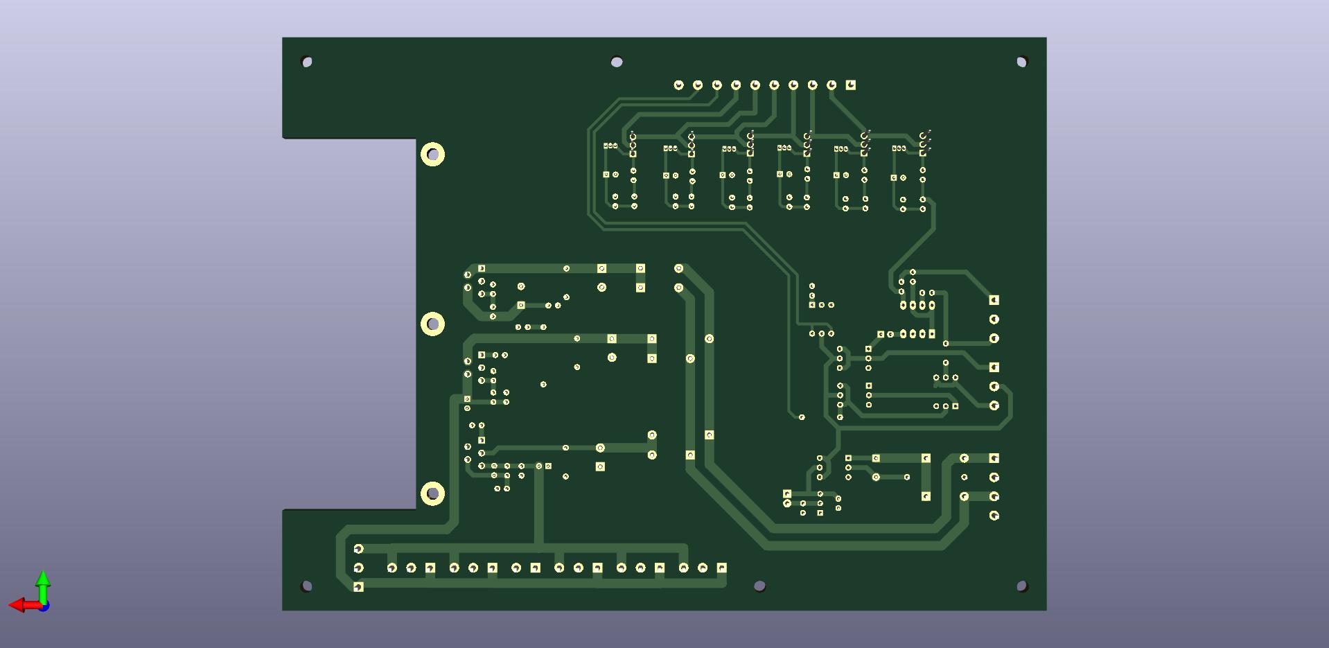

Most of y'all's suggestions I already tried, but I went back and checked again to be sure. First, a direct short between pins one and three (shutdown and ground, respectively) made no change with about a quarter of a volt when unloaded appearing at the output. I also couldn't find any voltage drops anywhere on the ground plane, and no voltage shown between the ground pin (3) and any other point on the board even when fully loaded. My 100Mhz scope showed nothing but nice DC with a very, very small bit of noise that I couldn't be sure wasn't the noise floor of the scope, and not a hint of 60Hz feedthrough in the outputs. I did go ahead and replace both 1963's just to see if they were the problem because I remembered that during my initial testing I connected the power transformer up incorrectly once and thought maybe that could be the problem...but that didn't change anything, just wasted my time and two regulator chips. I've checked everything I could think of and followed up on all of your suggestions, and I still can't find an explanation. When fully loaded the bleed-through voltage drops to about .02 volts and current is only a few microamps, so it's not actually a problem operationally, but it isn't nominal either. I'm thinking that if no solution can be found, I'll put a VOM1271/MOSFET switch before the regulator and tie the shutdown pin to the input pin and call it a day.
Here are pics of the front and back sides taken from the 3-D viewer in KiCad if it helps.
Oh yeah...In case anyone notices, there were errors in the boards I had fabricated...there's a trace missing between pins 2 and 3 on PRV205, and the entire section with the MOSFETs and TL431s near the ten pin connector got messed up somehow and required some "fixing" to get it working right...but it does all work exactly as designed with the exception of that one little gremlin.
