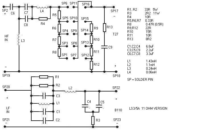

Not certain on it, but i think that the stirling crossovers are similar to the image attached. Would the 6 ohm impedance of the seas tweeter and the addition of an L pad cause any problems? Another thing i'm not certain on is whether i'd need to attenuate the tweeter more in this design vs my chorales. (-3.5dB in the chorale using a 2R in series and 12R in parallel)

I couldnt say. And that is my point. Without simulating the the driver response with the filter, i couldnt possibly say with much certainty. Some one may know otherwise, if they have used those drivers with that crossover. If the crossover is made for the SPH 135 then id probably use the low pass and modify the Highpass to suit the Seas tweeter. Id imagine, unless youre very fortunate, that you would need to experiment with different capacitor and or inductor and resistor values, so much of the tweeter circuit may need to be altered. At least the low pass should deal with rolling off the woofer breakup, if its designed for the monacor. With out frd file etc and circuit simulation its hard to predict the outcome. Its either trial and error, or learn a bit about simulating using the excellent frd tools out there for free. If you dont already that is. I have used frd tracer, and used files ive found at Zaphs, or from other DIYers, and together with Boxsim (also free) to simulate the frequency response, phase etc. Its a powerful too, and there others, some free, some not.

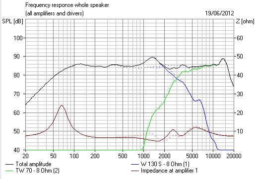

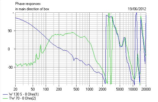

I really wouldn't fancy trying to clone a LS3/5A using entirely different drivers like the Monacor 5" polycone, similar as it might be to a KEF B110. You have to understand what was very precisely good about the LS3/5A. It was the notch filter on the bass along with great phase alignment and very flat frequency response. 🙂

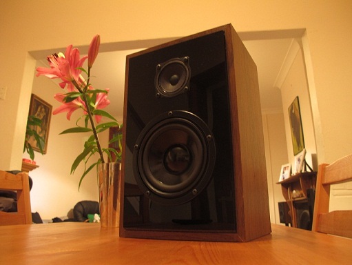

Let's look at Samadhi's WLM Stella clone, pictured below. The problem is the familiar bass hump at 1.3 kHz. You need a RLC notch to cure that accurately. That varies with the driver, in this case a Visaton W130S.

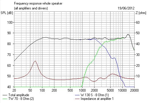

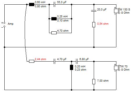

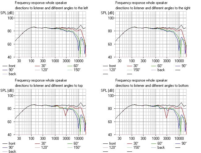

The next 3 images show the modelled response of a wallmounting bookshelf with a top class filter and a Visaton TW70. The last image shows axis dispersion using the smaller Visaton TW6 tweeter, which is my surprising current weapon of choice here. Thing that is good about Visaton is the modelling software.

The baffle geometry also has an effect on that hump. I used the same approach with my MTM's a notch filter at 1.4Khz made a big difference and also (when combined with the rest of the crossover) removed the need for any specific baffle step compensation circuitry.
