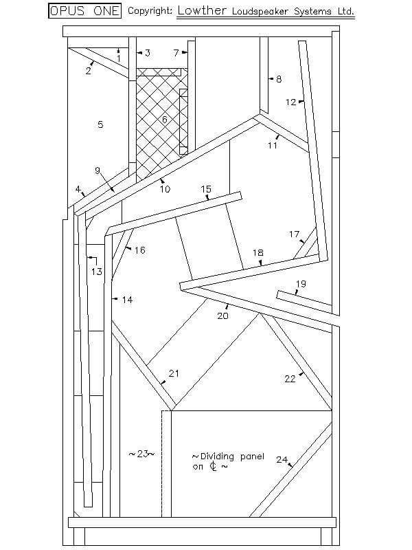

Hi there, you do not state WHICH Opus One you wish to build.
There are two. Model A and Model B.
I've been working on Model A for quite a while, with many interruptions.
Model B is simpler but I'm reliably informed that the bass drops "like a stone" below 60Hz."
I was told this by someone who built cabinets using Lowther drivers for a number of years.
Model A goes comfortably down to 30Hz.
Another retired cabinet maker I corresponded with in 2005, made both Model A and TP1 - he worked very fast and had them both finished within a few weeks. He had previously built a number of Lowther cabinets.
His impression was that Opus One A was very clear across the frequency spectrum. He was using EX4 drivers, and exhibited at the Heathrow Audio show in 2006.

You might like to visit here: Lowther OPUS 1 | Custom-made speakers and audio gear
An Opus One A build.

I think the difficulty of making Lowther-designed cabinets puts off many.
TP1, Opus One A and Audiovector are NOT easy to make. Jon van Halen, erstwhile Lowther America, described the Opus One A as an "awesome" loudspeaker in these forums.
If you want to listen to electronic thumping bass, then choose something cheaper and easier to make. Lowther drivers are very honest.

Regarding the Opus A, that does look a fearsome build. Having constructed horn loudspeakers in the past (not Lowther), if you have the room I can recommend something larger and simpler. Most of the convolutions in that Opus cabinet are designed to compact the horn length into a smaller space. Have a look at Nelson Pass's ideas for an extreme example of simpler + larger.
