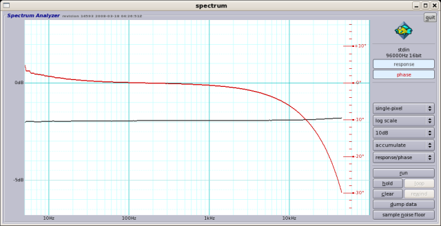

I have a full-featured linux spectrum analyzer, free and fully open, that works more in the style of a traditional bench tool than baudline (which is still a great program, and I use it regularly myself for music).
Source is at http://svn.xiph.org/trunk/spectrum
I'm in the middle of updating it (it's actually quite an old program I never finished at the time) to work niggles out of the automated testing modes. It also needs a nice detailed webpage to explain how you'd use it to the average newbie getting started. It works fine now if you want to go get it, it just needs more polish to be a real tool you can use with no real handholding. I've been polishing it up for about a week now.
It'll be getting its own thread as soon as I'm a little happier with the noise suppression in the automated testing modes and reenable the automated THD testing. If you're using a consumer sound card to drive/sample for it, I recommend a high-impedence opamp voltage follower to buffer the inputs.
Oh, and if you want a trustworthy program to do the sampling (that is guaranteed not to skip), http://svn.xiph.org/trunk/rtrecord will give you what you want. It will happily talk to the analyzer over a pipe, and also gives you a nice standalone app for those times when you want to use the computer as a bulletproof standalone sampler/hard disk recorder.
(attached a better screenshot of the analyzer doing something useful: A response/phase plot of a Cinemag CMLI-15/15B with a line impedence of 50 ohms, an output load impedence of 15kOhms, collected realtime using a pink noise sample, played and sampled using an emi2|6 with inputs buffered by a TL3474 opamp voltage follower. In short-- good results for equipment only a notch above 'BestBuy' and not even as good as you'll get from the Apple Store.)
