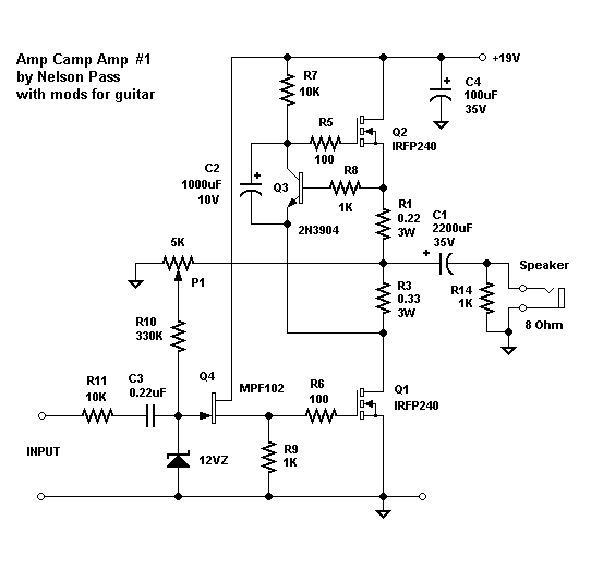

I'm looking for suggestions for a low wattage power amp to match that won't cost too much. Generally it would be played through something like a Mesa 2:90, but I'm going for something home friendly somewhere in the 2-5watt range. For testing purposes we ran it through a Fender Champ which actually didn't sound half bad, but I'm looking to spend less than $100 if that is at all possible.
Kits are preferred, but if it can get the cost way down, I'd be willing to source parts.
Any Ideas?

Check out the Amp Camp Amp in the Pass Labs forum. It's a class A design with only four transistors and runs off of a laptop power supply. You'll need a moderate sized heat sink since it burns about 20W. Output is 5W. I like the sound with the feedback disconnected. It sounds alot like a tube amp with lots of low order even harmonic distortion. Look for my posts in the Sticky thread. Kits are available but currently out of stock. It's easy to wire up on proto board.
Do you think that would really sound good with a high gain guitar pre amp? As far as I understand, the power section of a guitar rig colors the sound to a degree. Having any kind of solid state distortion would make all of that nice preamplifier distortion pointless. And a transparent amp would also result in an undesirable sound. Or am I wrong about this?
You won't be disappointed. The only thing you have to watch is applying too much voltage to the input. A 12V zener diode on Q1's gate to ground is all you need for protection. Leave R11 in the circuit to limit current and don't install R12. Use a MPF102 for Q4, the 2SK170 will be hard to find.
What sounds bad about solid state power amps is the high damping factor (>20). Most solid state guitar amps these days use a current feedback technique to raise the output impedance. They don't sound that bad. The Amp Camp Amp doesn't need it because it has a damping factor of about 2 without feedback. That's lower than most amps, even some tube amps.

A lot of people do not run their amps to full output (tube) and get their distortion from their preamp or pedals. As Loudthud says much of the difference between conventional transistor amps and guitar amps is the dampening factor. The low dampening factor makes the speaker more lively and delivers different amounts of power to the speaker depending on the impedance just like a tube amp does.
Well I'll put that on the list. The preamplifier has an AC coupled cathode follower and is supposed to have a low impedence output. Would that modification still be needed?

A push pull ecc82 stage should be ok, not too loud when pushed, can pull off some cleans, you only need 300v or so, look up the AX84 firefly. if you want more output gor for a 12BH7, i would think a push-pull output would sound closer to the higher power amp. though a chip amp may do the job TDA2030 with a +/-12v supply,

Something like the schematic below but some kind of Master Volume control between the preamp and power amp is suggested.

I am using Amp camp amp as my guitar power amplifier for home use. It sounds pretty good. Subjectively it doesn´t react to playing as fast as my all tube amp, but this is not an issue for me.
But I think it definately needs presence control. How can it be implemented in the feedback loop?
