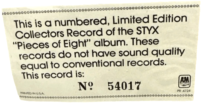

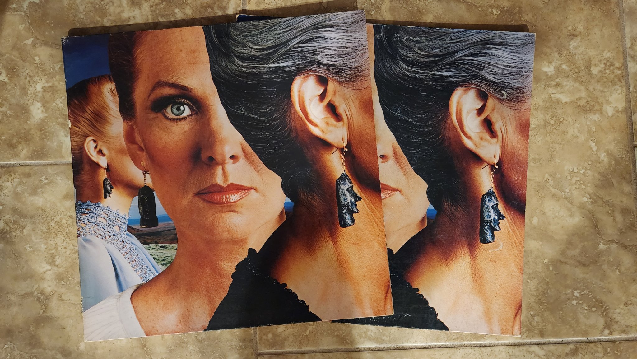

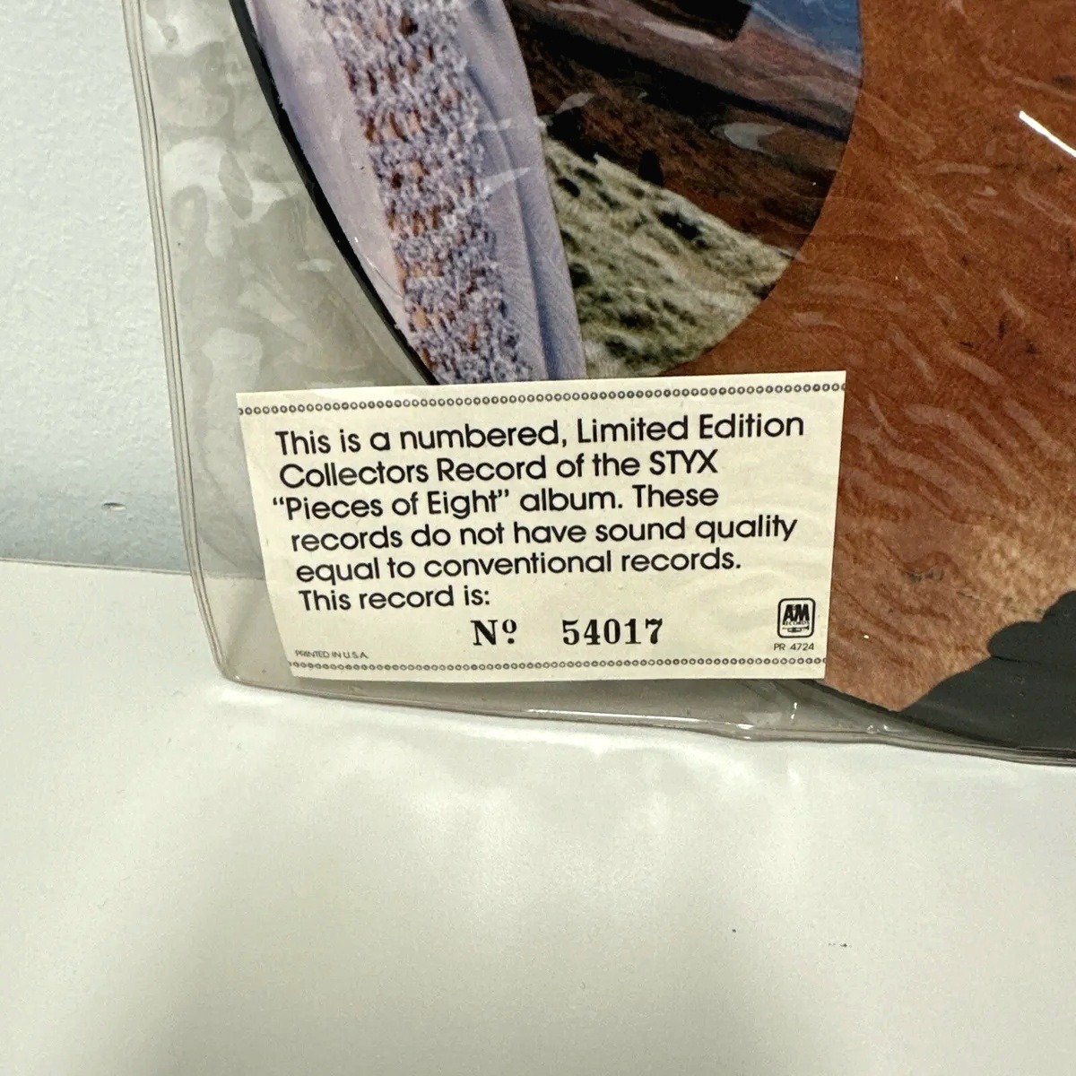

Hi all, just listening to some lp's when i came across this picture lp. I thing its a promotional thing as it does not sound as good as real lp.
What are they made of? Is it pvc?

The new generation of picture discs which appeared in the 1970s were made by creating a five-layer lamination consisting of a core of black vinyl with kiln-dried paper decals on either side and then outer skins of clear vinyl film, manufactured by 3M, on the outsides. They had acceptable but still inferior sound quality.
Information from: https://en.wikipedia.org/wiki/Picture_disc

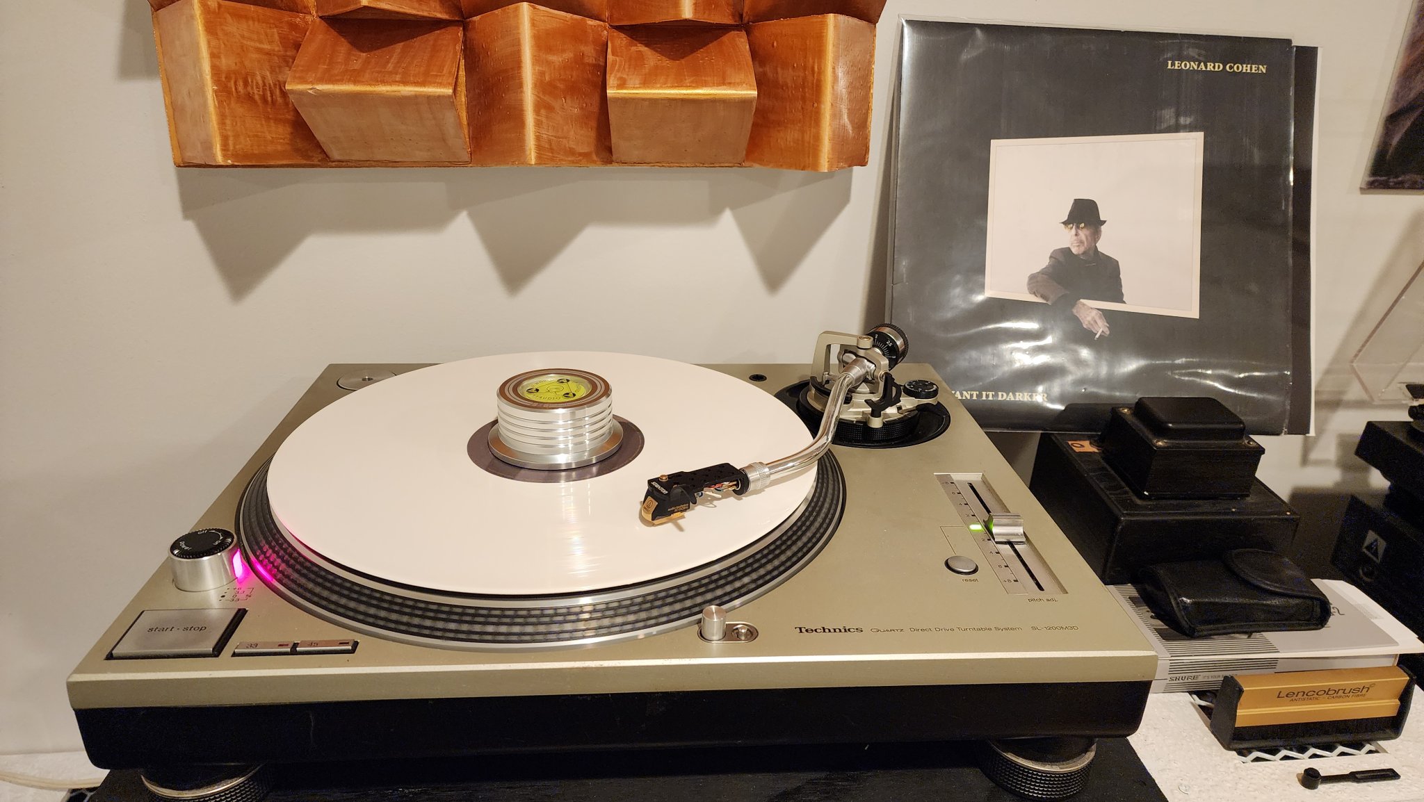

I have heard about the carbon additive before but assumed it was for color uniformity. Thanks Galu. I wonder what is added for adason's white disc, gypsum or talc maybe.
