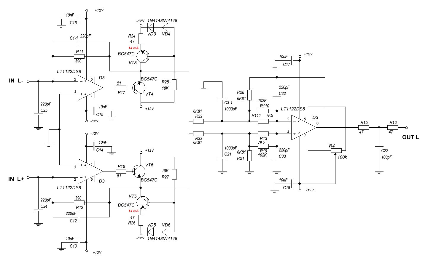

Can sc1815 be considered a direct replacement for BC547 in audio applications,without changing the B base resistor?
In general yes. It's a "cooking grade" NPN like the BC547. Just make sure that you don't exceed the ratings in the data sheet.
No components should need altering to use it.
Yes, they would definitely be 100% OK for that.
[The circuit is a little unusual just seeing it in isolation. The inputs are very very low impedance (a virtual ground). Is it used as an I/V convertor from a DAC ?]
Yes,I'll use it as I/v converter for dac , in dual mono ,and I'll need two of these as a result i think I get xlrafter the transistors at 3.16v if I'm not wrong but was afraid of the base resistor and the difference in freq 80 vs 300mhz
The base resistors are OK left at 51 ohm. They isolate the opamp output from the B-C and B-E junction capacitance of the transistor and prevent any stability issues. The absolute value won't be very critical.
Absolutely no problem with the different ft of the transistors either.
