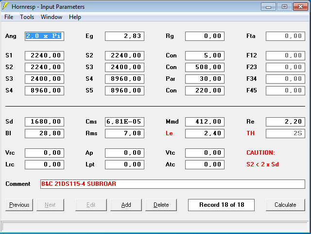

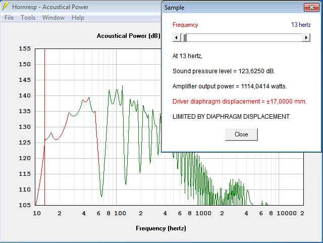

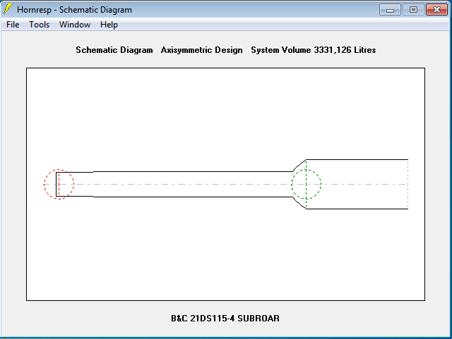

A large 221 ROAR, based on standard plywood dimentions and tuned for sub-bass duty is probably the most directional design except for large full sized horns. It takes two B&C 21DS115-4 and two kilowatts to reach 123 dB at 13 Hz in a 2 pi radiation space (free field outdoors).

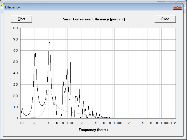

Here is the difference in efficiency between my ROAR design and the same two B&C 21DS115-4 in a 600 liter bass reflex with a 800 cm2 port, 100 cm long (grey line in the graph).
