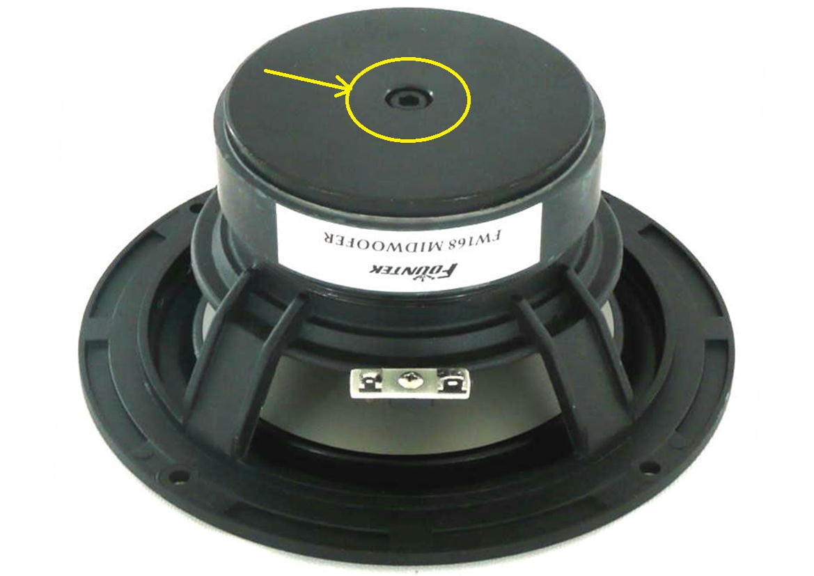

It is likely that not the center pole piece that is offset, but the phase plug, which is either glued, or - the better case- fastened to the pole piece with a bolt. (going through the center pole piece). In the second case you can try to loosen the bolt a bit, [if it is accessible on the back plate] and center the plug manually. In the first case... well, you are screwed 🙂D), because the glue they use won't let it go easily.

I've already try to loosen the screw and re center the phase plug... but there is no margin at all, the plug is touching the aluminium coil support all the ways.

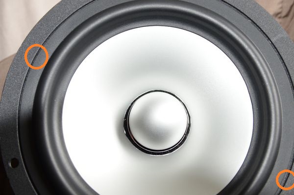

Upon looking at the photo of the FW146 , now I think that the entire cone with the surround is glued offset to the frame. (The gap between the edge of the rubber surround and the frame is not even around the perimeter)

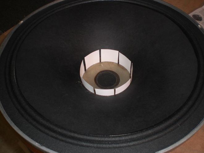

If you are brave enough to do it, you can try to peel off the rubber surround from the frame (you can do it with a sharp flathead screwdriver and a tweezer -but very slowly, and carefully, few mm at one time- then "re-center" and re-glue it with slow setting contact glue (test it, it should not dissolve rubber....).
I've done this a few times with about 80% success rate. 😉
You can get the idea how to do the centering on the attached picture.
Try different thickness paper strips, until you can move the cone up and down (but not too stiff) , then do the surround glueing. After the glue set, remove the strips, and it is done......

- The worst solution is gluing the phase plug directly on the pole piece but it is irreversible.
- The best solution is to use an threaded adapter with a smaller diameter screw that offer more adjusting margin.
The fw168 I purchased recently have similar build issues - mine don't rub but are mighty close. T/s Parameters are also way off - Fs 20hz too high, vas halved, qms too low.
I didn't notice you could unscrew the plugs, might try that!
Removed the phase plugs from mine - one had enough slop due to the raised part being smaller than the recess on the pole piece that I was able to center it properly and tighten it down. The other didn't have any slop but by rotating it the alignment is now much better than it was.
You are a lot more lucky than me, i'm building a M6 to M4 thread adapter, the two poles pieces should be perfectly centered with a margin of +-2mm.
