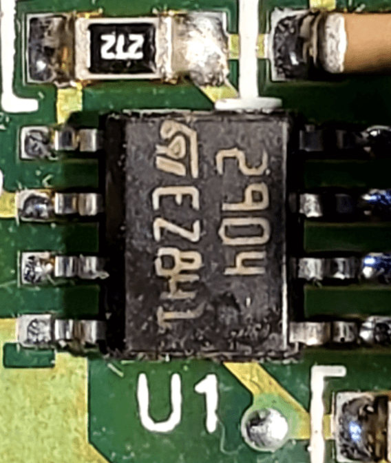

This is part of a motor control for an oil vent damper made by Field Controls.
I'm trying to identify the part labeled U1, and a source, if possible.

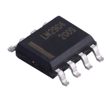

The unusual layout of the part number threw me off. So any idea what the EZ numbers are? Usually the date code was the 4 digit number and the alph a numeric was the part number, but you're indicating this is reverse on SMD parts.
Every LM2904 sohc I have found has a clear labeling that makes sense. The IC in question does not.
I did find something called an LS841, dual jfet. I'd try to trace the pcb as best I could to make sure it is an opamp. And would a fab date of the 29th week of 2004 make sense for the part? If true, even more confirmation 2904 is the date code not the part num.
Reactions: 1 users
I'd be willing to bet on an LM2904, too, as it's cheap, runs on a single supply, and has the advantage of including ground in its common mode input range. The LS84 is a dual jfet made by Linear Systems, and it doesn't even come in the same package as the part in question. It's also not made by ST, and the part (U1) is definitely from ST.

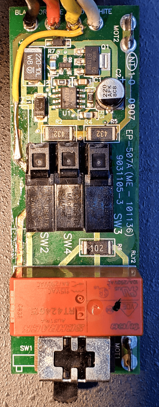

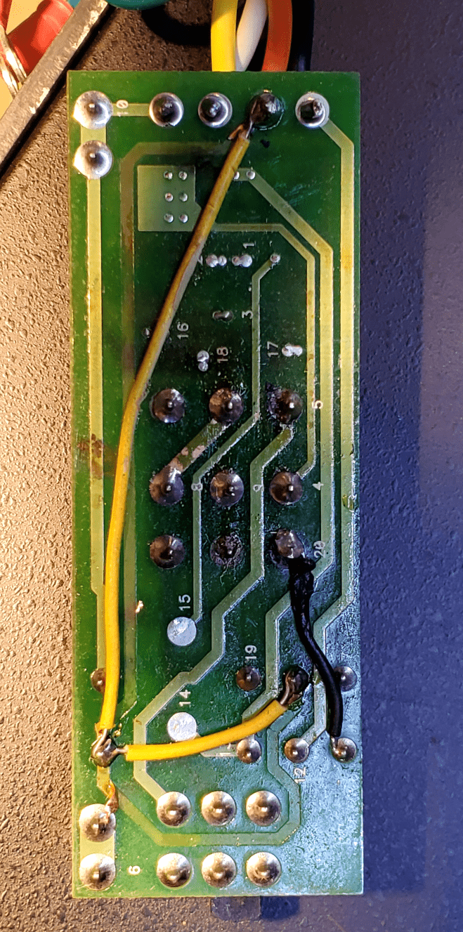

This is what the board looks like. I have two of these units that failed. This one failed one day when one of the micro switches got stuck. It made a loud pop when it failed. That was the sound of traces being blown off the board. The second one failed quietly, no visible damage. Just won't operate.
I have repaired the blown traces, but the unit continuously spins the motor instead of turning 90° and stopping.
This PCB is only about an inch and a quarter wide. It's too small for my eyesight to really see. The 120VAC comes in on the black and white wires. Orange goes to burner and yellow is the sense wire to the aquastat. Tracing this out to a schematic on paper is going to be tough, as I can barely see stuff this tiny. From what I can tell, there are some resistors a couple of diodes (D2?) and a transistor and 8 pin IC of some sort. Only one filter cap. Seems really minimalist. No surge protection whatsoever!
