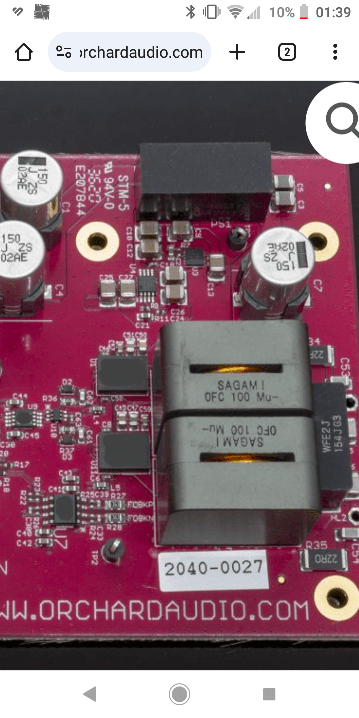

I saw Sagami OFC shielded used in Starkrimson modules from Orcharaudio, so I know that exist but the problem is that I don't know where to buy...
https://orchardaudio.com/shop/starkrimson_150w_amp_module/
You will find this type of inductors for class-D discontinued: https://www.sagami-elec.co.jp/en/product/discon.php
Whether or not the marking "OFC" was related to oxygen-free copper - who knows?
The properties of the ferrite and its magnetic history will probably dominate the properties of the coil, be it Al, Cu or OFC. Did you know many ferrite materials are irreversably affected by bringing a permanent magnet up to it for instance?
Worry about the core material, not the conductor, with inductors.
