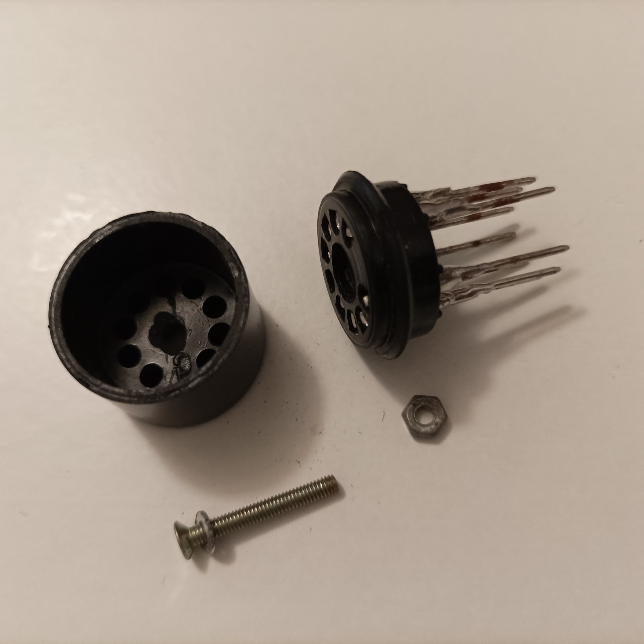

One challenge is the pin compatibility, I've not found anything else that's a drop in. I'm think of using a socket saver as an adapter, hacking and resoldering the pins inside with tinned copper wire and fill with silicone sealant, to prevent shorts and breaks. In my case I'll need to fit longer standoffs on the pcb. My reasoning is more due to cost and availability of the usual WE417a/5842 which have become more expensive and rare with time. 5847/WE404A is like the pentode version and cheaper. Some pins match but not all, in triode mu is similar but perhaps Schade feedback is a possiblity for more gain.

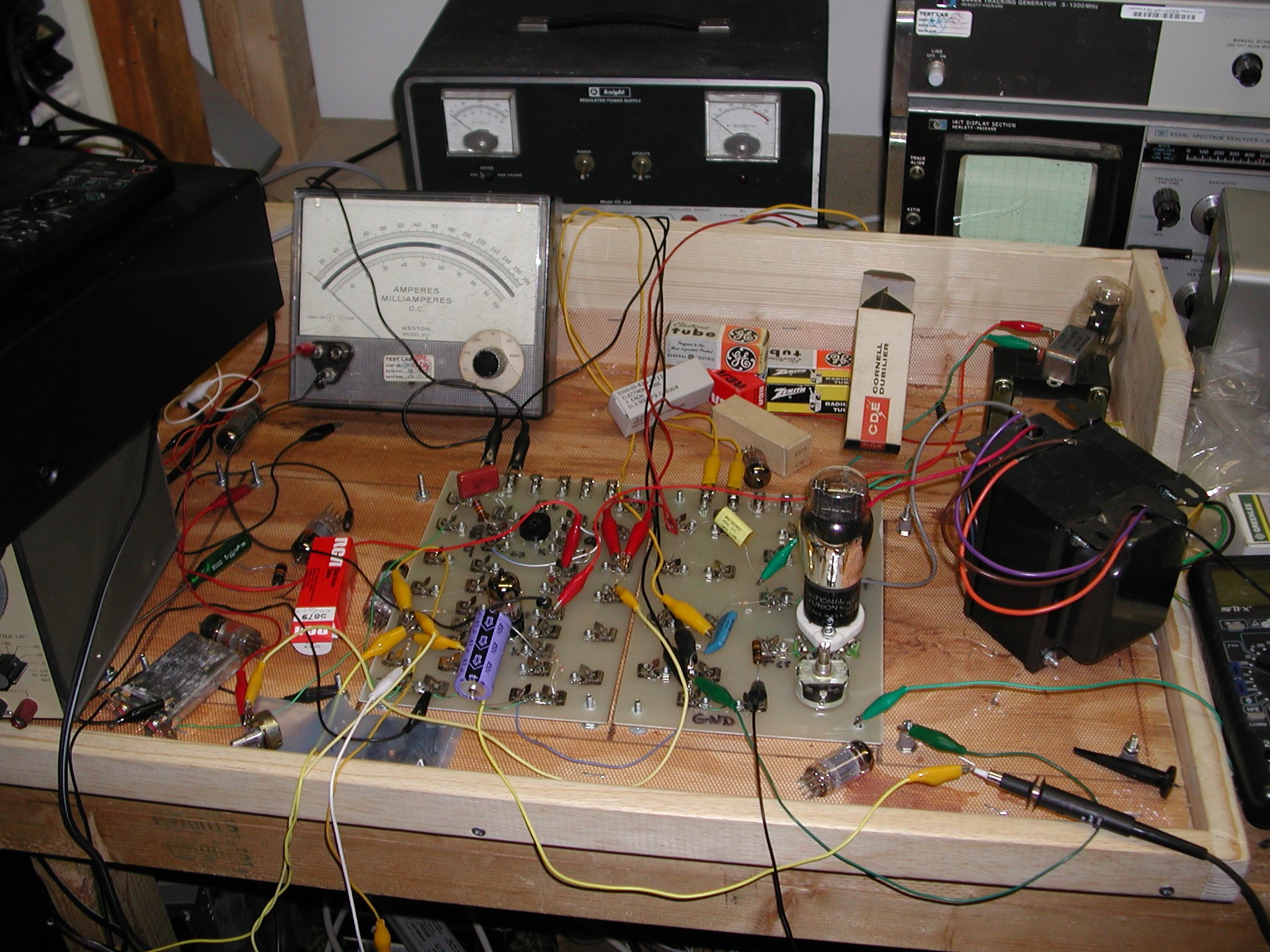

The original TSE design evolved from about a year of experiments on a crude breadboard that I called the "tubelab" over 20 years ago before Tubelab the company was even a dream. I had been given over 100,000 vacuum tubes in exchange for a few weekends worth of work cleaning out the warehouse where the tubes and a huge stash of aircraft parts from the post WWII era had been stored. Stan who ran ESRC with his father Irving had his warehouse in Boynton Beach near where I worked at the time. We occasionally met at a local Wendy's at lunchtime to talk tubes, politics and everything in between. I also had access to his inventory list, prices, and sales data to decide on whether to use a tube or not. The 5842 was $3 to $4 at the time and nobody seemed to want them.

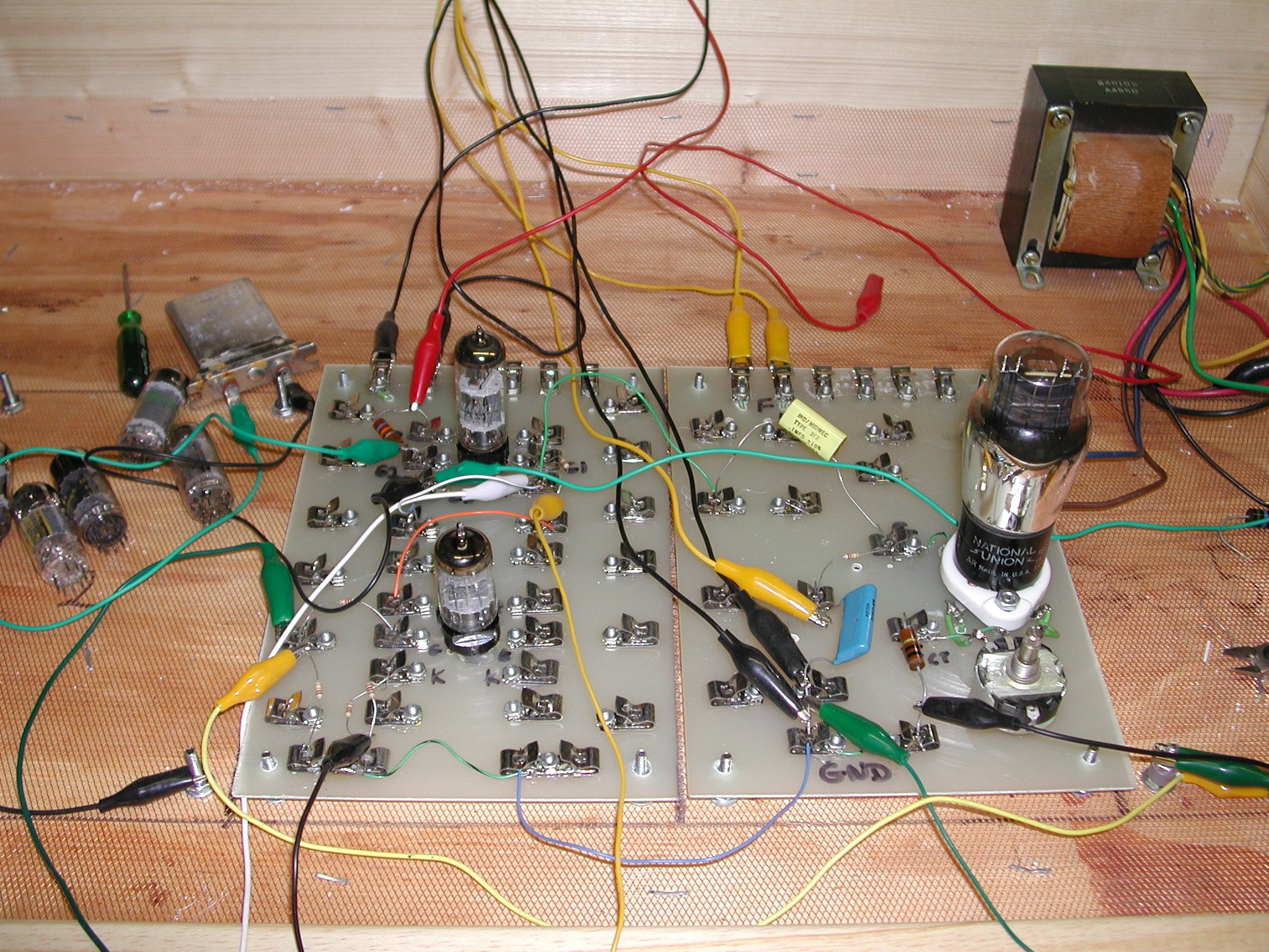

Picture #4267 shows the 45 being driven by a 12AX7 with a CCS load which was created with a 12BY7. The IXYS 10M45 chip did not exist yet. I happened to remember a "constant current diode" device that I used as a current limiter to prevent GaAs fets from blowing up while I was trying to make a 4 GHZ amplifier. Picture 4289 shows the 12BY7 being replaced with such a diode.
Once I discovered the CCS diode loaded triode, I simply tested every tube that I had for use as a driver in what would become the TSE. I had a crude FFT analysis system and, I also used listening tests. The 5842 was a clear winner with the 7 pin 6J4 a close second. I know that the 6AM4 was also a contender since I have pictures of some being tested. The mosfet follower came a bit later to buffer the load presented by the grid resistor and the output tube. This lets the input triode to run under nearly ideal conditions for maximum gain with lowest THD.

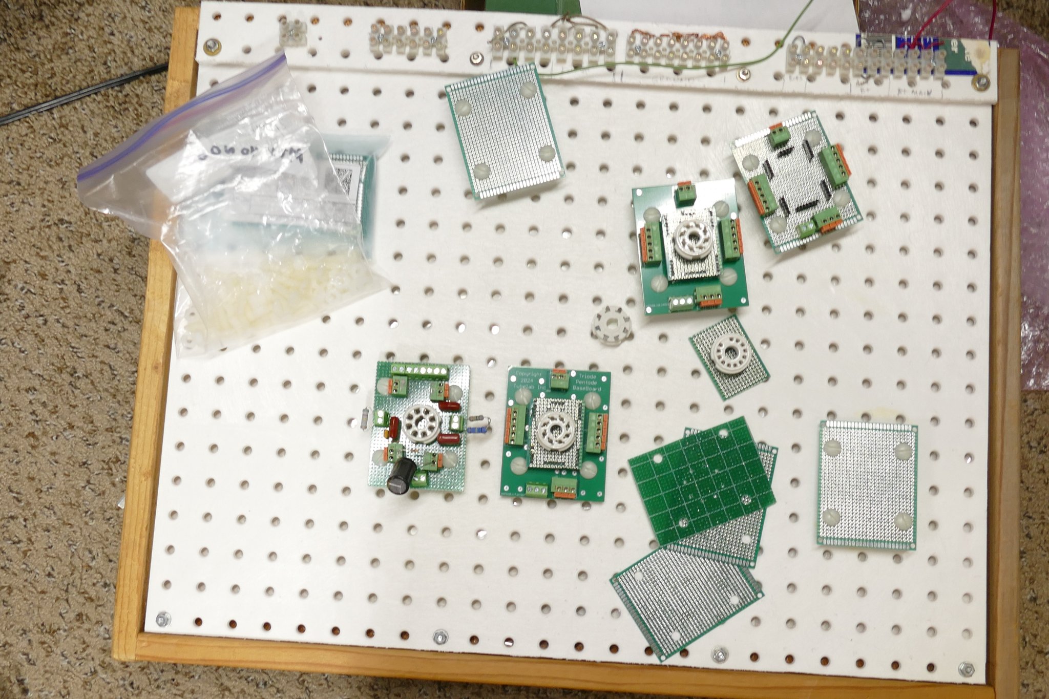

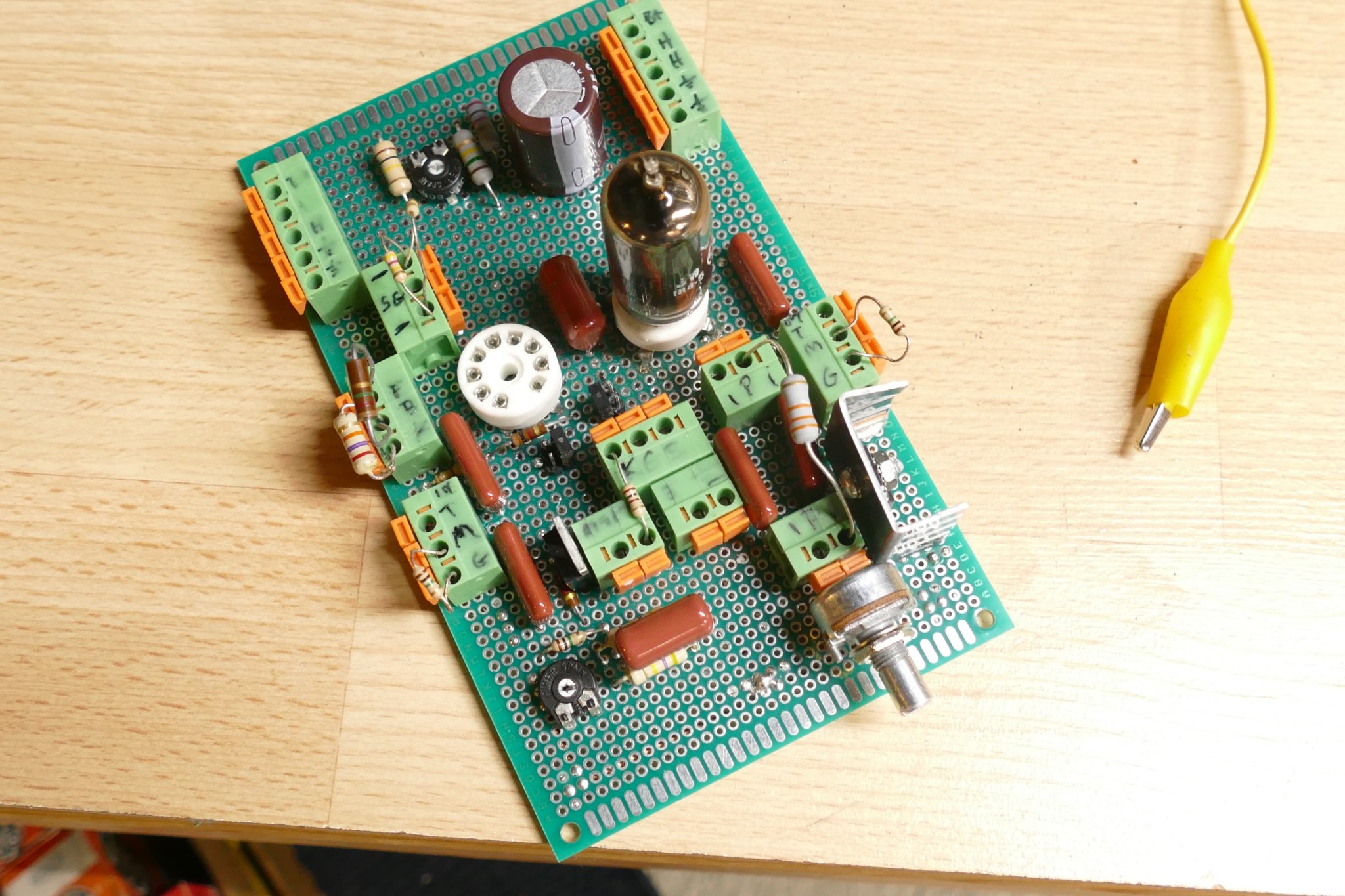

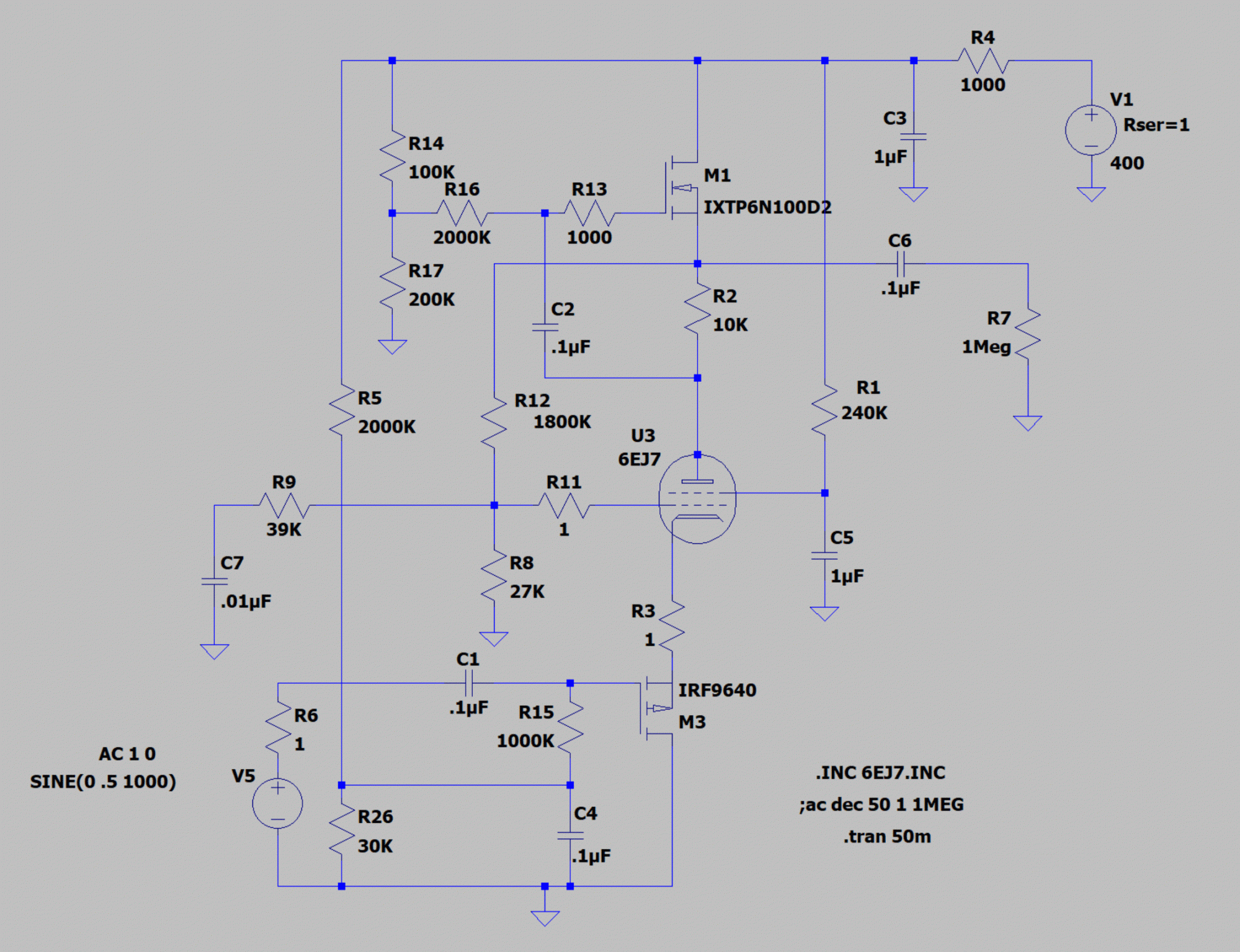

Getting 7.5 db more gain from a single triode will likely be impossible. Since your amp does not use the Tubelab PCB, you have far more options available depending on how much experimentation you are willing to do. I have been tinkering with a new driver design that uses a pentode in a rather unique circuit. Very high voltage gains are possible with low THD and relatively common tubes. My test board has two sockets, one for 7 pin tubes and one for 9 pin tubes. There are over 50 different tubes that work well in this design.
The R14, R17 pair set the plate voltage on the tube. R16 sets the load resistance that the tube sees which greatly influences its gain. R12 and R8 set the feedback level. The direct plate to grid feedback turns the pentode into as "pseudo triode." The ratio sets the slope of the triode curves.
The old "tubelab" breadboard still exists but it has gone through a bunch of changes. The wood and copper screen base are the only original components left.

Thanks George. I hadn't considered an UNSET driver. I have some 6EJ7s left over from my 100W Engineer's Amp build.
Here's my schematic. Not quite a stock-standard tubelab SE.
I have done some testing with a 6EJ7 as an UNSET driver, CCS loaded, was able to get 50V+ RMS on a 10K load, 1% THD, cascade harmonic profile. I was very impressed. George has better results, less THD.
