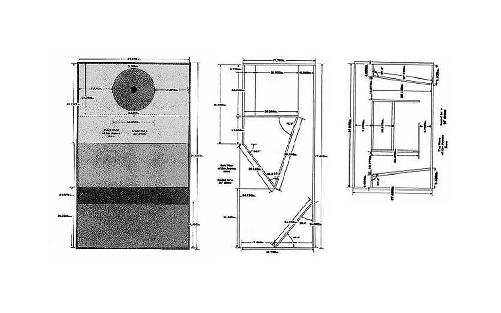

Have you seen the plans for the Jensen Imperial?
While these plans have been "super-sized" for a 24" driver, you could scale them for a 12" by dividing everything by 2...
Here is the actual link to the super-sized plans...
http://www.steevee.com/jensen/jensen.htm
Half-sized, they are about 4' x 3' x 2'.
qi said:While these plans have been "super-sized" for a 24" driver, you could scale them for a 12" by dividing everything by 2...
Greets!
You can't scale horns this way, any more than you can a sealed or vented cab, unless of course you want Fl, Fh to be much higher.
GM

GM said:Greets!
GM
Thanks for the clarification, Greg.
Use a scale factor of .625, not .5 to get the original Jensen Imperial dimensions. The original design uses a 15" driver, not a 12".

Greets!
One more time..... you can't scale a cab this way and expect similar performance! Anyway, Steve's design is enough different from the original that he shouldn't be referring to it as an 'Imperial' IMO: http://www.highefficiencyloudspeakers.com/user/Imperial_Build-in.jpg
GM
GM

Yes and no...
I am just using simple math to scale a "super-sized" design back to its original state.
The plans you posted are the originals, and known to be flawed and very difficult to work with.
Actually the website you reference confirms this.
Steve's plans are easier and more "buildable" IMO
