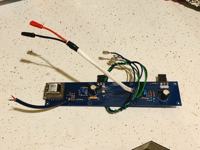

I'm in the process of building the Aleph J (my first big build), but excited about the prospect of being able to try out other First Watt amps that use the same power supply (F4, in particular). For those of you that have experience using one chassis and PSU with various First Watt amp boards, I'm curious to know if you have any build tips that would facilitate the swapping out of boards, i.e., solutions that would minimize having to desolder and re-solder connections and that kind of thing.

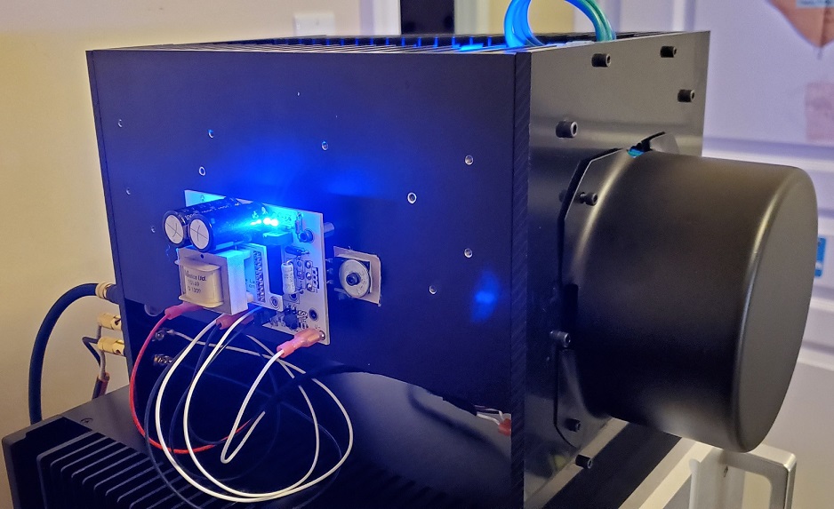

I’ve just finished up a bit of this kind of optimization for my chassis. I think the biggest thing would be to use quick connect tabs or wire terminals (I’ve had better luck with former) for the PSU connections. I’d also utilize quick connects for your binding posts if they have that option. For me, it’s been easier to solder dedicated power, source and speaker wires to each board. Then when it’s time to swap, it’s just a matter of disconnecting a few connections, unscrewing boards, and swapping in the new pair.
Use spade connectors for power, ground and output if possible.

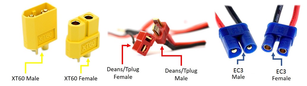

Another option is to put splice connectors in the wires instead of at the board. I have done that using radio control model battery connectors. They are designed to handle high current, are polarized and also come in male/female couplers to minimize mistakes in connections.

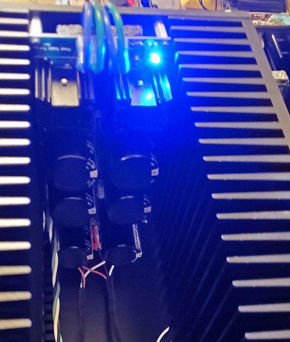

Another option I considered was picking up an extra set of heatsinks for my chassis from Modushop (if you’re using a case from the diya store). Kinda pricey way to do it, but it allows you to keep your boards mounted and protected.

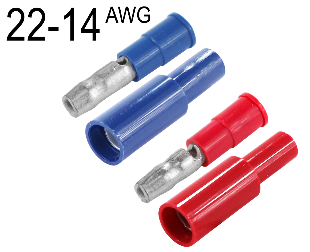

Another connector is the bullet wire connector. That can be used for the ground connection in conjunction with a rc battery connector in a bipolar power supply. The smaller gauge connectors can also be used for low level signal wires.
This is my approach also.
I much prefer the quality of Deans plugs over spades.
