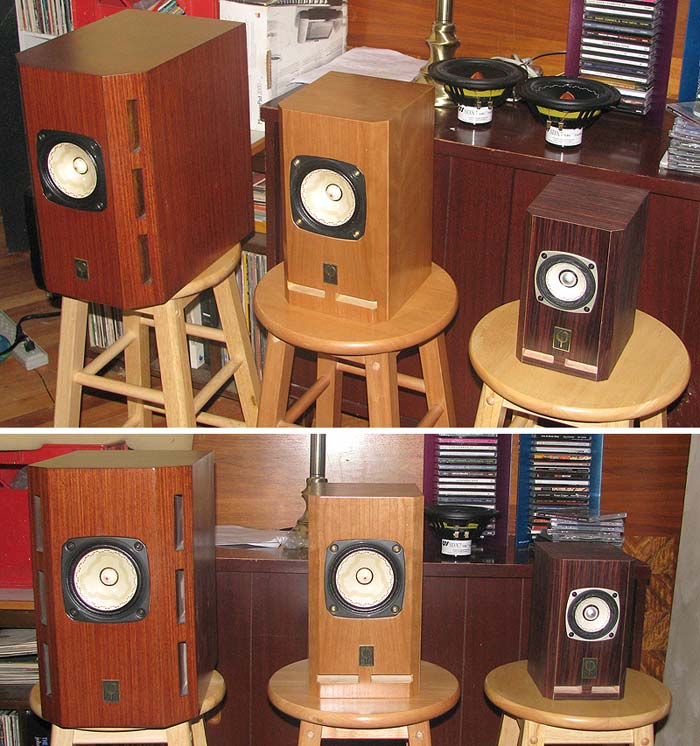

I'd guess that the speakers pictured are Fostex FE126 in the recommend BR design ( 10.5 liter / tuned to about 60Hz) - it's approx 85mm deeper than the single BR design for the FE127, 10liter / tuned to 71Hz. Both those designs are available at Madisound's website.
In theory there might be some advantages to a down firing port, if it's close enough to the floor - otherwise it simply makes for a more awkward stand mount- then of course there's debate over rear or front firing port. FWIW, I think the final arbiter of that question is the ultimate installation - many of the smaller designs might well fit on a bookshelf or table top flanking a TV screen, but performance of a rear port would be severely compromised, and a down firing port would be out of the question.
The FE126E is far better suited to a BLH design, and unfortunately those tend to be physically much bigger than either of the BR designs. Of course if you're intending to stand mount a little BR cabinet of any design, that's a moot point, as the total footprint of some small floorstander designs might not be any larger, and I dare say the performance of good examples of the latter would more than compensate for any extra floorspace. Enclosures such as the Mileva, PAWO, Brynn, BIB, etc immediately come to mind.

Having built more than a few of them myself, I can attest that there are quite a few "DIY" designs that easily outperform many of the Fostex "factory" designs, and in particular those for the FE126/127. For example, there are numerous designs posted on the Planet10 website Box Plans Library,
http://www.planet10-hifi.com/boxes-fostex.html
Of particular interest might be the Fonken family - most notably the first 2 on the list. The Fonken has already enjoyed quite a few DIY builds (aside from the 8 or so pairs I've built myself) - the total dimensions are not hugely greater than those of the factory BR, and within limits imposed by the driver's T/S parameters, the performance is quite superb.
Dave has a downsized Fonken design for FE127E, for which the drawings have not yet been published on his site - they give up some of the bass extension and articulation of the larger box, but are a substantially easier build. e-mail him at his website if interested

mFonken (milliFonken) was a stab at making the smallest possible box for the FE127. Took us 3 tries to get it right It is 4.5 liter (almost exactly the same as the BBC LS3/5A). And about the same bass extension (good to ~90 Hz).
With the necessary proximiity of the walls of the box it gives up a bit of openess compared to the larger Fonken.
Plans just need one more QC pass before they go up so i can mail the existing to anyone that wants a head start.
They are the ones in the middle.

On the cabinet behind the Fonken trio in Dave's picture, discerning eyes will note the latest version of CSS SDX7 mid-woofer, with optional EnABL process.

mr_macgee said:I'm also limited on dimensions. The width can not be more than 7", the depth no more than 9.5", the height as high as 12".
If one assumes 12mm (1/2") BB then you have a maximum gross internal volume of ~8.8 litres allowing for some bracing.
What is the largest driver I can have within those dimensions while still achieving a high quaility sound?
You can fit FE127e or FR125SR. What amplifier are you using (that could seriously sway the choice one way or another)
I was a little confused between Fonken sizes and which drivers go with which box, I could not find dimensions for µFonken & milliFonken.
The FE127e goes in all the Fonken boxes except for the µFonken (FF85k). The CSS FR125 goes into a miniOnken
The Fonken & miniOnken are identical except for the port heights and the shape of the internal holey brace. The GR & FS Fonkens are the same "size" as the regular Fonken but twisted into different shapes to suit different needs, (all of these have a net volume of 13 litres)
The mFonken is the smallest box i could squeeze the FE127 in (net 4.5 litres). The µFonken is net 2 litres.
I have added the preliminary plans for the mFonken & µFonken to the Fonken page (please report bugs & omissions. That and a 3D visualization for the mFonken are all that are missing from these plans)

As we have moved forward we have personally come to prefer the FR125 in a 4.5-7 litre aperiodic/resistive vent box.

No two driver models will sound exactly alike, even in enclosures optimized for as close to identical performance as their respective T/S parameters will allow.
A perfect example is the CSSFR125 in mini-onken and the FE127E in the Fonken.
Ultimately the factor of personal preference will enter the calculus, and once you'll got a sense of yours, you need the confidence to override advice of the best intentioned arm-chair quarterbacks. That many of us have arrived at very passionate support of specific driver/enclosure combination should be no surprise, and our choices will not satisfy everyone.
FWIW, and if not already abundantly clear, my current favorites are the FE127E in any of the Fonken designs into which it'll fit, and the FF85K in the microFonken. Note that the latter definitely needs bass support in anything other than intimately near field (i.e. computer monitor) application.
Having said that, if you're willing to pay the not insignificant sensitivity penalty of the XBL motor design, for bang for the buck in the teeniest package, the newest version of FR125 in approx 5 liter resistive vent box would be pretty hard to beat.
My most recent build for those was Dave's design with the angled back and rear facing vent (array of small holes partially stuffed with resistive damping foam). He could advise if a near wall installation would be detrimental to the performance - my intuition is that an overhead boundary might be more of an issue than the rear - but I've certainly been wrong before.
If front firing ports are mandated by placement, I'd imagine the mFonken could work as well - although the tuning of port slots would likely need to be adapted. Early in the prototyping of this smaller cabinet, we played with a standard round port, and definitely preferred the sound of the slotted port - it takes only slightly more work, and actually contributes to the side to side cabinet wall bracing.

Hi Guys,
After doing a lot of homework and looking at my current setup and the future use of these speakers for desk or in a bedroom. I've decided to go with mFonken and will order Planet 10 FE127 .
Dave thank you for posting the drawings (I had no problem opening them).
I do have an academic question to Dave and I hope my not stepping overbounds. Looking at my setup, it would be nice if the box could be narrower but I do have room for a deeper and taller box.
Looking at the mFonken drawing; Is it possible to make it narrower by 24mm by omitting the beveled front edge and eliminating the internal corner bracing and then increasing the other 2 dimensions (H" x D") in order to keep the correct volume (4.5l)? If so, how much?
I believe I calculated .6 liter lost with the narrower width that must be made up somewhere else.
I do realize the port dim. will have to be altered (increased) to keep same tuning. Holes for the internal brace will also have to be altered.
This is more academic and I'm very curious to learn if this is possible while keeping the same performance and sound. Is there a dimension ratio that must be kept? I've already found a A/B marine Baltic Birch sheet at my friends woodshop to use for the project.

mr_macgee said:Looking at the mFonken drawing; Is it possible to make it narrower by 24mm by omitting the beveled front edge and eliminating the internal corner bracing and then increasing the other 2 dimensions (H" x D") in order to keep the correct volume (4.5l)? If so, how much?
It is possible. An earlier iteration was narrower. But the proximity of the side walls resulted in quite a bit of reflection back thru the cone, making the skinnier box quite a bit boxier. Widening the box just a bit (about 25 mm) made all the difference in the world. A larger champher also helps make the box dissappear a bit more.
The skinner box was still good sounding -- at least until you switched to the wider box.
dave
