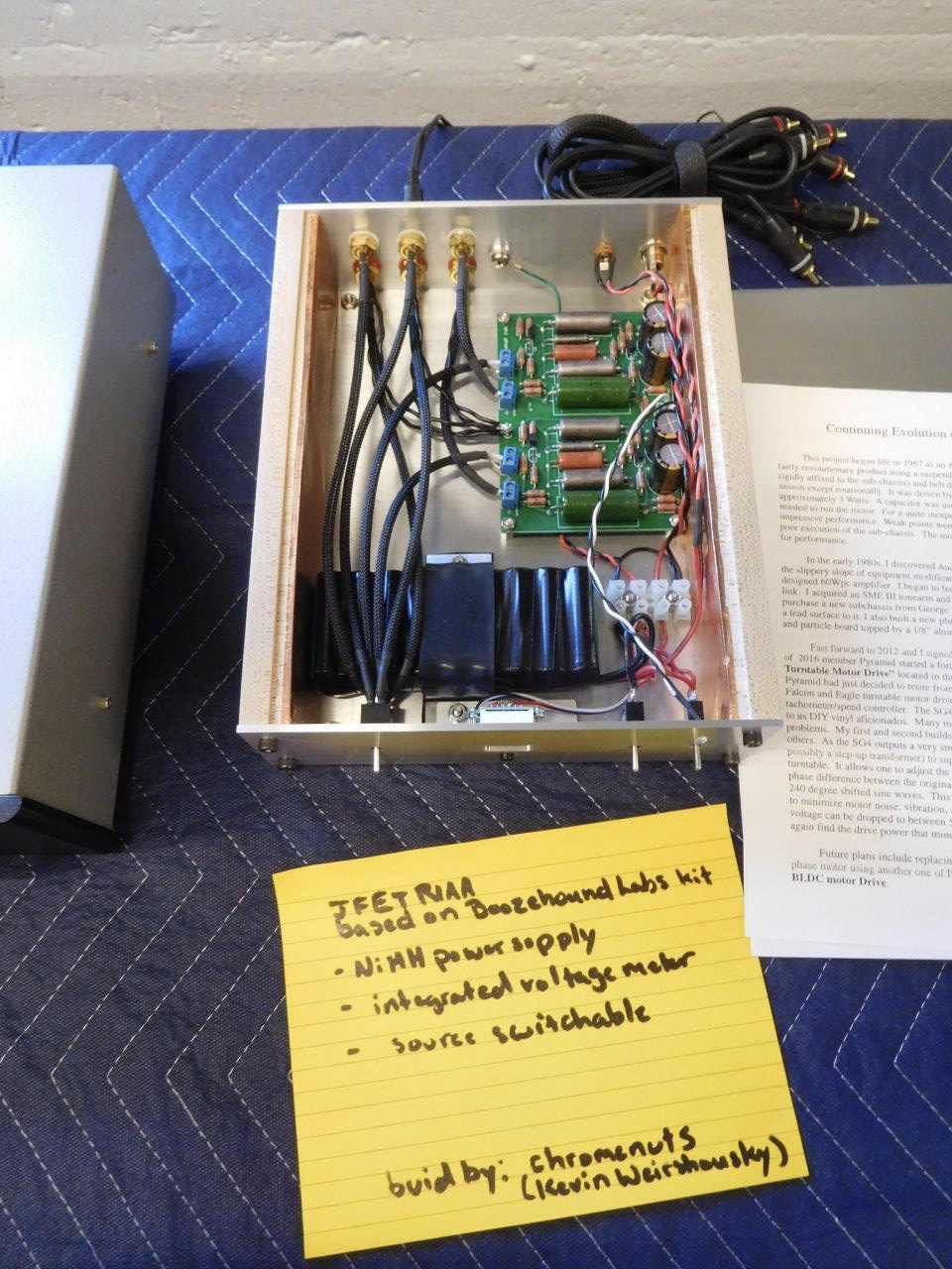

JFET Phono/RIAA Preamplifier kit – Boozhound Laboratories
I built this Boozehound Labs original version of the RIAA phono amp as a first phono project. It was only supposed to be temporary until I built a Salas FSP kit or Pearl 2. It’s dead quiet and sounds good so I haven’t rushed to replace it.
I used a NiMH rechargeable battery supply and gave it a switch for two sources so I could use an MC head amp on one line and just MM carts on the other. Added a voltage meter to monitor the supply.
Even brought it with me to BAF ;)

SO im using with a tube pre and also have used it with solid state. What I mean is that it sounds very good and is very quiet. I have built about four other units with tubes and discreet fets and bipolars in parallel. All of those designs are very critical to layout and cabling as far as noise is concerned. the opamp version does not seem to suffer from that. Newer modern opamps sound very good also.
