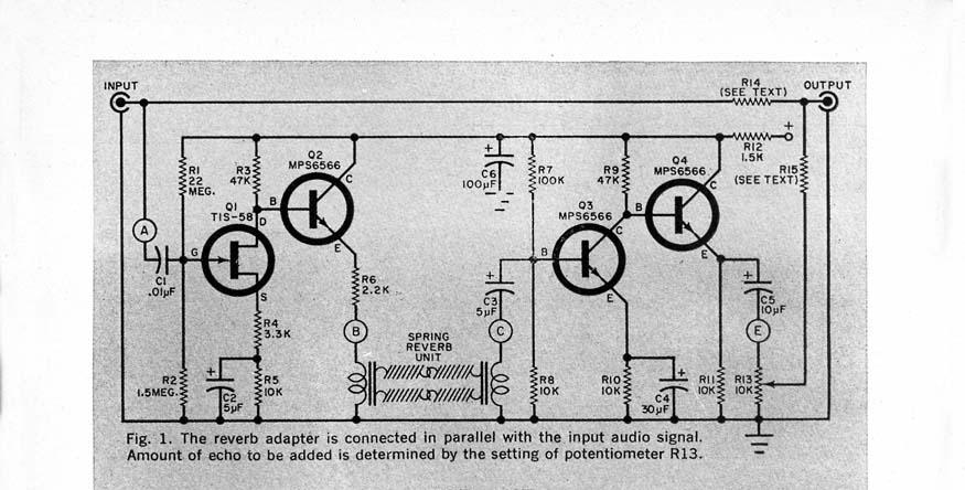

Thanks for all the replies. Maybe I should give some further detail, in case there are other alternatives you can suggest.
I want to experiment with a kind of mechanical feedback control for my spring reverb system (I'll attach the circuit I built). The purpose is to get some ringing/droning sounds while sound is played through the springs.
Originally I wanted to just use a pot to feed a controlled amount of the (100% reverberated) output signal back to the input, but after some experimenting I couldn't figure out how to make it work, not much helped by my lack of experience.
Enzo suggested in another thread that I could try aiming a small speaker at close range to the springs in the tank driven by an amplifier, fed from the reverb recovery output. The speaker I have is from the inside of a PC case.
The reason for the 27V supply is because the reverb drive/recovery amp requires ~30V to operate to its potential. The amp doesn't have to be 1W as such, so a higher powered amp will be OK if that's what my 27V supply dictates.

I know it is way more fun to conceive of a quick little NPN amplifier
GoatGuy
You are certainly right, GoatGuy. I would definitely prefer that route, but if a little regulator and a 99c chip amp as posted above is the way to go, I will go that... way.
