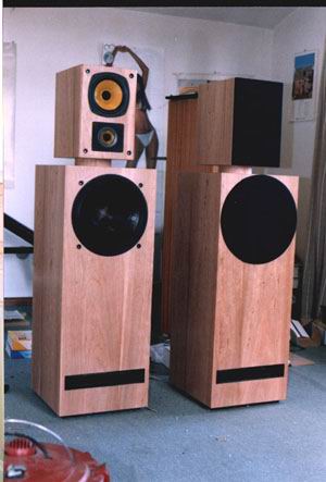

I'm lookink for a 12" woofer in order to make a passive system with
a Davis 16GKLV6M and a Audax TW034.
The primary idea is to cross at 350 Hz first order as was done in a kit called MV15, see pdf in attachment.
I think the speaker must match few criteria :
- sensitivity around 96 db for 3/4 db BSC (16GKLV6M is around autour de 92 crossed by a self of 0.6 mH)
- max enclosure size around 90/100l
- price 200 € max
I've seen two beyma references wich seem interresting :
12LX60V2 : ~200 €
SM112 : ~120 €
Has anyone used this speakers ?
Any advices welcome :)
  • mv15.pdf

new 12" Mivoc looks interesting, and can be weight tuned for closed box
I'm looking for the refs.
but most 12" Pro/PA woofers seem to have very high Fs
Original woofer had a fs of 38 Hz, Beyma SM112 has also a FS of 38 hz.
T/S parameters below of the 31TCA12 :
PN: 150W - QTS: 0.31 - FS: 38 - VAS: 216 - BL: 12.6 Re DC: 6.9
sensitivity 96 db/2.83V
if its to change an already existing speaker, I suppose you know how to change the crosover for the new woofer
I hope so :)
Thank all for the answers,
ScottG, the 12LW30 seems to be an interessting driver :)
Another candidate could be the one of the AE TD12 serie, I've asked AE for the shipping costs.
I'm going to do simulation with WinISD for all the drivers expet the 12BR70 who needs a ~90l enclosure.
I also own a sub 60l enclosure that could be used for tests.
