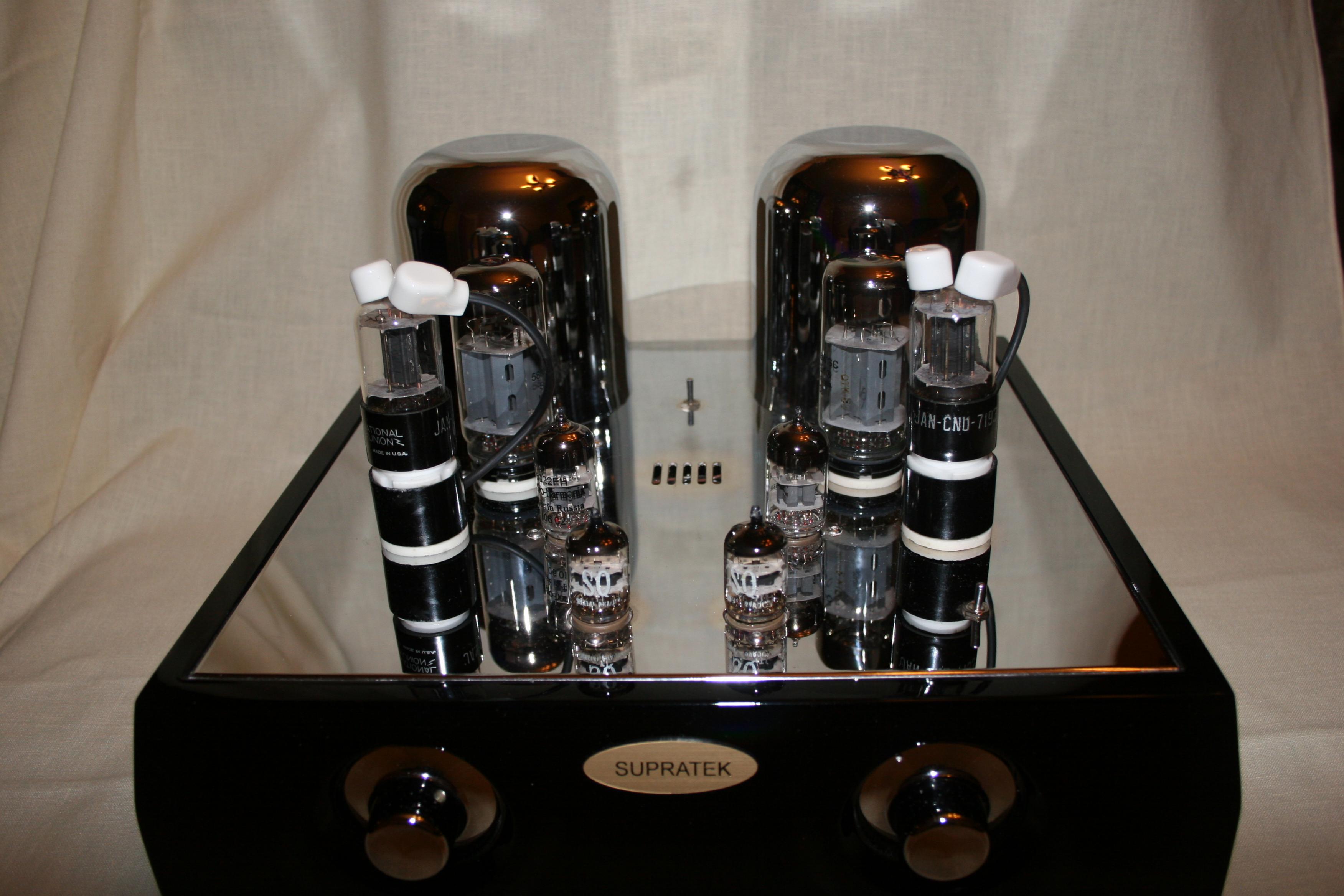

If you're in the mood to modify your amp, the 2C22 is basically 1/2 of a 6SN7, with top caps for the grid and plate. They are very inexpensive ($5-10 per tube) and available NOS in legendary US brands such as RCA and Ken-Rad.
I find them to sound better than any 6SN7 I've ever heard. There are some reviews on the various audio sites - haven't heard a bad word about them.
I modded my Supratek preamp to use them in place of the stock 6SN7s with a nice improvement in clarity (see picture attached). I was able to get by with only one section since I didn't need the gain - for an amp you might need two per 6SN7 replaced.
I've since moved on to a DIY 26 preamp, but the Supratek sounded good too, though not is a league with the 26.
