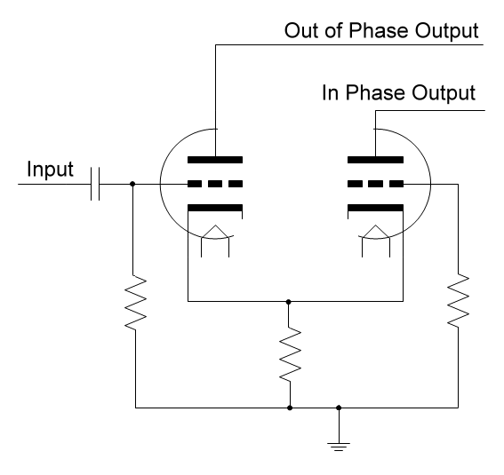

Is this generic schematic of a long-tail pair phase splitter correct? Are there any additional parts (resistors or caps) that need to be added? I am using the schematic in a review. I drew it from looking at numerous variations on several websites.

You are missing the plate load resistors, and perhaps output capacitors. You are also missing grid stoppers, and the input cap may be optional, depending on the presiding stage. And I almost forgot, where is B+? (called Vcc by the vulgar)
By the way, that is not a long tail pair. A Long tail pare would have a negative supply. Idea is that the cathode resistor is very large, to approximate a CSS.

This is where I got most of the schematic for a long-tail pair phase splitter:
The Long-Tail Pair
Is his schematic incorrect, or did I just leave something out of my own schematic?

Requirements to values of long tail resistors and cathode bias resistors are very different. If you use in your schematic the value that is good for LTP tubes will be starving. If you use the value needed for proper bias it's no longer a LTP since the value of this resistor is too low for LTP.

nope - same issue identifed above by waveborn - thats a short-tailed pair...

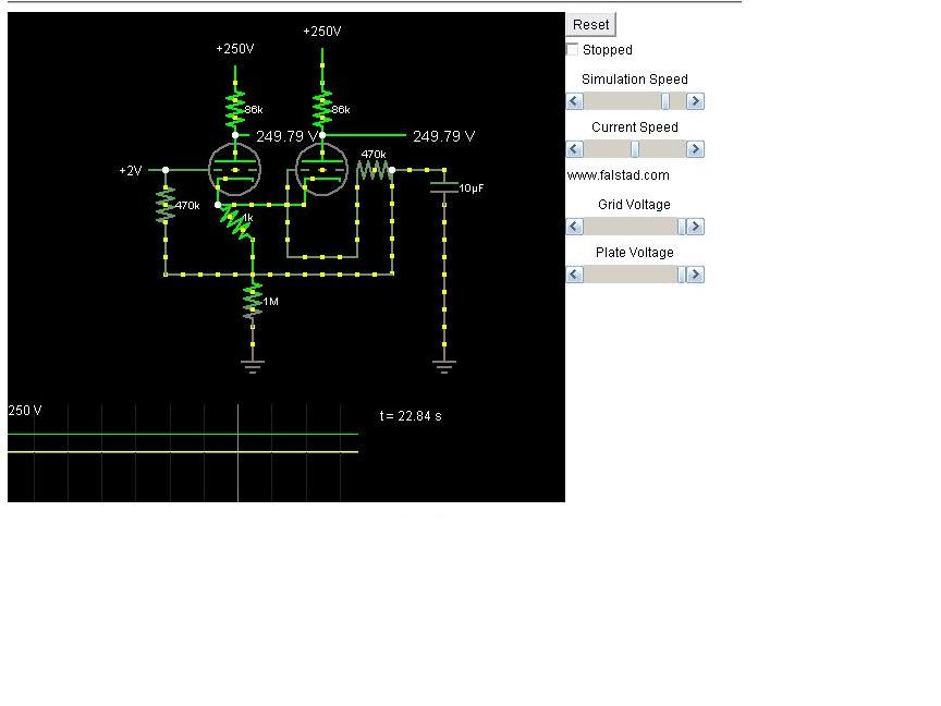

the below software is great as posted before.
http://www.falstad.com/circuit/e-mosfollower.html
I was playing around with it and you can create anything (only limitation is the type of triode), but it has CCS, resistors etc etc.
With this LTP below you can vary the tail resistor and see the effect on the output voltage. 1M will give you equal outputs (small pentode maybe), but 47K will not, but then you can try changing the plate resistor values until they match.
Really simple and fun. And you can save your work as a text file when you press export. Then import it after.
