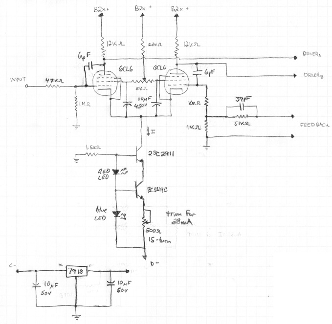

I guess I can say this since I have all the 6CL6s I ever need. Using a 6CL6 LTP in pentode with a SS BJT CCS, I managed about 150 Vpp (single ended) out with <0.5%THD (my measurement limit) at 1KHz. Power supply was +340 and screen was 150V. Plate resisters were 12K and CCS was at 28mA. Single ended gain was 35V/V. It drove PPP EL34.
What it went in.http://www.audiokarma.org/forums/showthread.php?t=140121

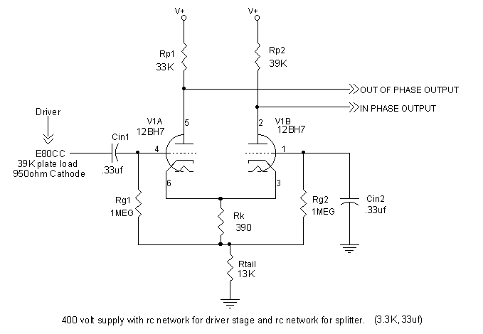

I use the same basic circuit in a 70 and it works Quite well.
BUT!!! Using much lower plate resistance tubes and different value plate resistors.
(Plus a driver tube in front of the splitter, no cathode bypass)
I use an E80CC for the driver tube to an 12BH7 for the splitter.
(many different tubes can be rolled in for the E80CC)
Yes you could do things to the tail, but I find this arrangement works well on a 70.
Something along these lines is the basic layout.
Cheers!
(Didn't look at the output phasing on there drawing, but wired like the drawing I posted it's fine.)
