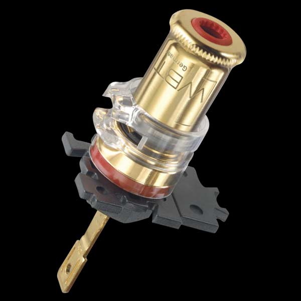

This is perhaps sacrilege, but the only Cardas binding posts I've personally used were the special patented ones, and I found them a total pain in the rear panel to install and use.
They do make a rectangular metal plate to simplify installation, as the Parts Express plates are nice as well, but the cheap round input cups and hole saw if you don't already own one can be purchased for less than the high zoot parts, and installation is a pretty quick.
If I was going to get any fancier than the cheap terminal cups, I'd probably go for the Eichmans
or WBT Next-Gens.

"2-3 dozen pairs a year", Chris-- those will put any anticipated retirement plans on-hold!This is perhaps sacrilege, but the only Cardas binding posts I've personally used were the special patented ones, and I found them a total pain in the rear panel to install and use.
or WBT Next-Gens.
