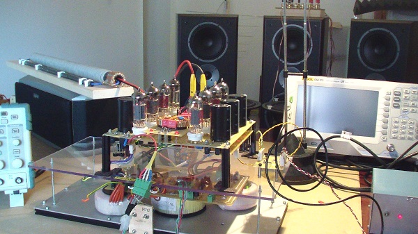

Third, just to have a look, here is a picture of one of the only two (...for now...) Switchinglow existing EVMs under evaluation in my lab.
Foreground on top is the triodes half-H bridge, over its power supply unit.
Small board on right is the PWM analog f/e.
On left an home-made ferrite clamp to measure conducted EMI
with the spectrum analyzer, on the right.
Three Magnat Supreme 2002 on the background with a simple h-m
junction box for connecting them in various mode.

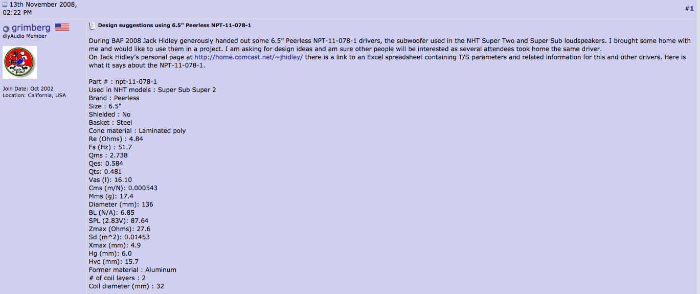

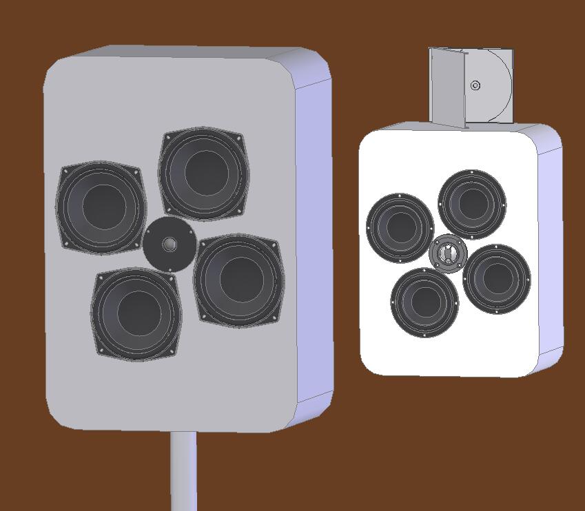

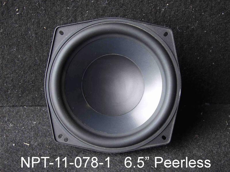

There are many of these 6 inch 8-Ohm Peerless 850397 midwoofers floating around this area, so perhaps a design using 4 per side (32 Ohms) could be developed to accompany Marco's amp?
I volunteer to whip up a 3D model if approved.
Also I have a pair of Vifa D19TD-05-08 3/4inch poly dome tweeters lying around, but they're probably not worthy?

4x 8 Ohm midwoofers can be fine.
My aim is first of all to demonstrate a concept.
Only one side is request as the evaluation kit is monophonic.
