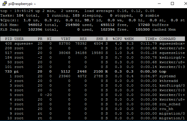

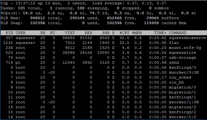

Don't think it was the disk after all. Installed a different one. Still the same. Play a 24/96 file...and it does not take long...then crash.
Installing htop is not working for me: sudo apt-get install htop
message: E: Unable to locate package htop
So I tried top. And that's already installed..when the pi crashes/freezes....this is the last I see.
Compare that with streaming from another LMS server...virtually no load.
Or even when playing on the same LMS but with a "normal" flac.

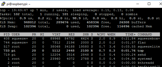

Another thought....
I just took a closer look at the top output you posted:
http://www.diyaudio.com/forums/attachments/pc-based/540850d1459366833-lms-squeezelite-working-rpi3-raspian-but-get-errors-top.jpg
Note that the second highest resource hog is 'FLAC' - this doesn't show in the top output from your RP2, and neither do I see it on my top output:

You may want to take a longer look at the LMS setting Advanced/File Types/FLAC - it looks like you're set to transcode to another format rather than use FLAC as a native output to SqueezeLite.
This would be a rather unnecessary waste of CPU resources I think.
