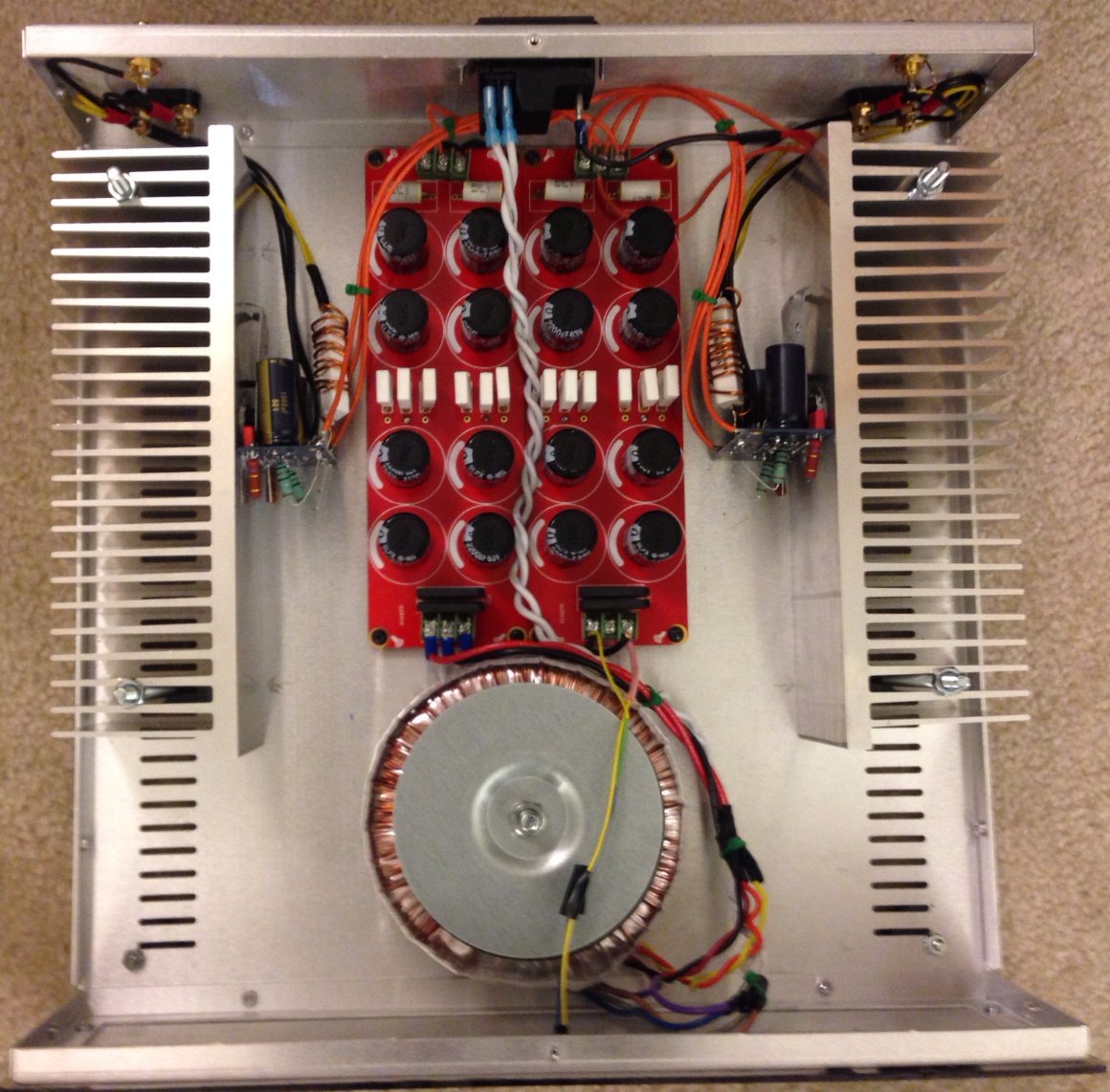

Hi there,
I finally finished my LM4780 parallel amp using Audio Sector boards (Fig1). I use Avel 25VAC 500VA transformer, so I get about 35VDC for pos/neg rails. I first tested the amp with the fast recovery diodes provided by AS, but it gets really hot for two channels at 35V, so I decided to use two CRC boards lying around. They have 8x2,200uF each. As can be seen from Fig2, bridges become really hot.

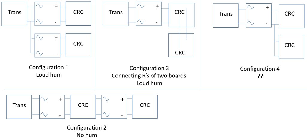

When doing this, I found something strange. See Fig. 3.
I first tried Configuration 1, because I have two CRC boards and only one transformer. It produced very loud hum/buzz. compared to using only one CRC board. I don't understand why this happens.
When I series connected to CRCCRC, there was absolutely no hum. (Conf2)
I got curious and tested Conf3, connecting R's of positive and negative rails together, hoping it just parallels C's, and it produced as loud hum/buzz as Conf1. I don't understand this either.
I haven't tried Conf4 because it was hard to access bottom side of the board (and I am lazy to disassemble). It's basically using only one bridge, but use separate CRC boards. What will happen?

Your drawings don't show what is going on with the earthing - this is very important, and most often at the root of hum issues.
Also, when you say hot, how hot do you mean?
Aside: I don't see any fuses in there - or am I missing something?

Ground/earth are connected from each CRC board to one star ground point. I will add it to the figure later.
The heatsinks become about 45-50 C at full power output.
I don't use fuses in DC rails. I know it's more safe, but since papa (Nelson Pass) doesn't use them for his FirstWatt circuits. I have a proper main fuse.
