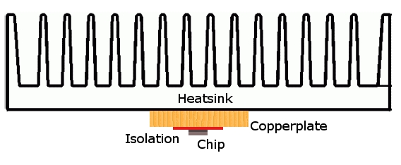

in my opinion the heatsink for two (you used two chips each in parallel-mode, right?) chips is toooooo small! also i think this heatsink isn't good for cooling without a fan: the rips are too close for passive cooling...
In my 4780er i used a heatsink with about 0.8 K/W thermal resistence. Because auf the dimensions of such a heatsink you have to spread the active area of the chip by adding an additional heatspreder. I put a copperplate with about 4 or 5 times the chip area and 6mm thickness between chip and heatsink so i increased the active area which transferes the heat from chip to the heatsink.
BTW: don't forget to mount the chip isolated on the heatspreader/ heatsink...

The backside of the chip holds a metall area, right? this is for better thermal flow to the heasink. This Area is connected to V-!!
So if you mount this unisolated on the heatsink and the heatsink is mounted directly on the metall case ALL metall areas are connected to V-!!
THIS IS VERY DANGEROUS BECAUSE OF THE HIGH CURRENT PEEKS AND DC-CURRENTS YOU DONT NOTICE IF YOU COME IN CONTACT WITH BUT YOUR BODY WILL DAMAGE!
