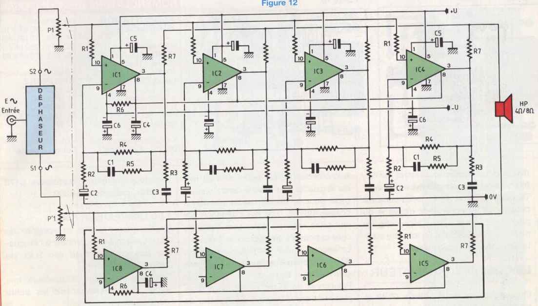

i want to build a 280watt with 8 lm3886 ;/channel to make a home cinema
what do you think about this
R7 are 0.22 ohm
+u and -u are +- 40volt
what can i change in the diagram to improve the ampli
cordially

What is the purpose of P1?. I think part of figure 12 is missing,if not, both side s1 and s2 should match( r4,r5 and c1).
Volumepot?
I think they have just skipped the feedback part because the schematic would be "blurry" ?

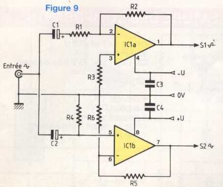

If dephaseur is a chip(ie. drv134)that will split the signal,why would two pots be needed. they might add balancing problems.
from what i understand, parallel amps need to be closely matched as possible. so they are not driving into each others outputs and causing heat and distortion..
each of the 8 amplifiers has 3 capacitors (1 electrolytic even) and 4 resistors affecting the feedback loop.any variation will cause difference in the outputs and distortion.
try and match them as well as you can.
I also wonder what may happen if spike protection was to kick in at different times on the different chips.

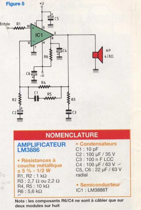

I was wondering why you would need to repeat the zobel network R3/C3 for each chip.
Also, isn't bridging into 4 ohms a problem.
the diagram of the balanced preamp
so i won t use this preamp , i will use the dvr134 or other
in the diagram of the ampli lm3886 i use 1% resistors, silvermica 1% for the10pf=c1, c3=MKP 1%, and C5 C6=1000µf
we can use c1 10pf to 40 pf what is the best for c1
cordially
