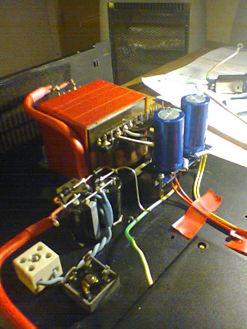

The project is housed in a 19 inch rack mount 3u case which i liberated from a cheap chinese amp. (chassis was surprisingly good).
I used two traffos. The B+ comes from a traffo that powered a small valve tape recorder that came from a skip. It powered a dual triode using a voltage doubler so thats what i did. The traffo for the LM3875's came from a kenwood stereo. It has multiple secondaries. 23-0-23 is powering the chips and 12v rectified for the valve heaters. This is due to me using 6H1N valves and the valve traffo's heater winding wasn't great.
The can type rectifier in the first pic was used to test the heater circuit. it has since been removed and replaced with a board containing MUR860 diodes and some electrolytics. This cicuit running from the red traffo is 12v dc and draws a constant 520mA. This is with the heaters in series. The datasheets suggest 12.6vdc @ 600mA +/- 50mA. Im confident im close enough, if anyone can advise me further on this please do. Ive decoupled the heater pins on each valve with poly cap.
The thick red cable is for the mains inlet, switch and traffo's. I scrounged it off the guys who came to fit fire detectors in my block of flats. It is mains rated twin plus earth solid core with a metal fire shield and bloody brilliant for any mains connections.
The big blue caps are the main supply caps for the 3875's (10,000uf 43v) with a small poly underneath the board and 2.2k resistors to bleed the caps. The "underneath" of this board also holds 4 mur860's arranged for a center tapped secondary.
I will be posting a full collection of pics to go with this build, and schematics etc as ive adapted certain parts to suit.
