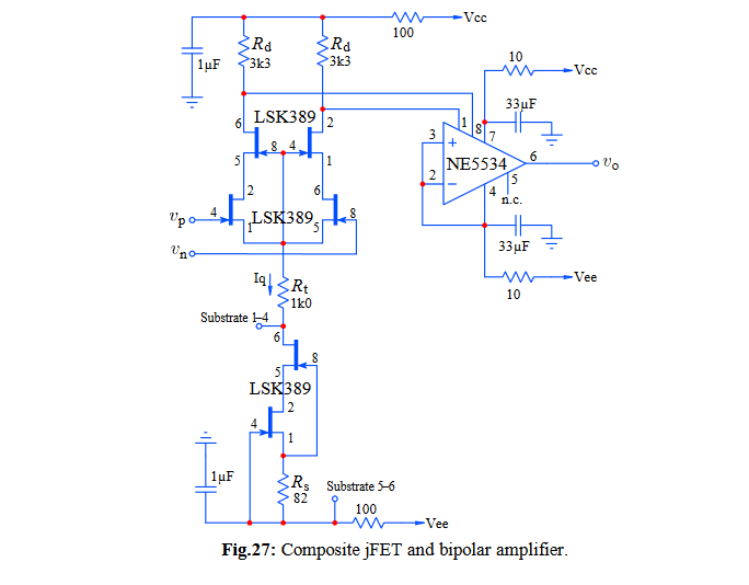

I have never measured it stand-alone, but in the Myref composite amps of Mauro Penasa, applied as input stage / control amp. The obtained results were put on here, at around 0,00015% up to close to clipping.

http://www-f9.ijs.si/~margan/Audio/Ironing_RIAA.pdf
page 37-38 and your riaa pre too
i wouldn't go fet all the way , bipolars are better for CCS and cascode transistor, but you're a smart guy

For ultra low noise and distortion, Analogue Device AD797 is still king of the hill.
The AD797 has very low _voltage_ noise, the current noise is far less impressive, so for many common audio circuits its significantly noisier than the 5534A, it would be a real mistake for instance to use it for a MM phono preamp (MC, very good choice).
The truth is from 1k5 to 20k _very few_ opamps are quieter than the 5534A.
This is absolutely correct. I use a AD797 up to 2.5 k source which is a 10 k pot in the electrically central position (so 2 x 5k n parallel). Much above that and there are better choices.
I am mightily impressed with the OPA1641 BTW - low noise voltage and virtually non-existent noise current.
