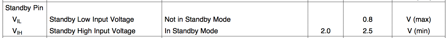

Here's what the LM1876 data sheet says about it. It looks like a 5 V TTL compatible logic input. Just apply at least 2.5 V to get the chip into STDBY.
If you're using a single power supply, you'll need (VCC+VEE)/2+2.5V on the STDBY pin to engage the standby function.
