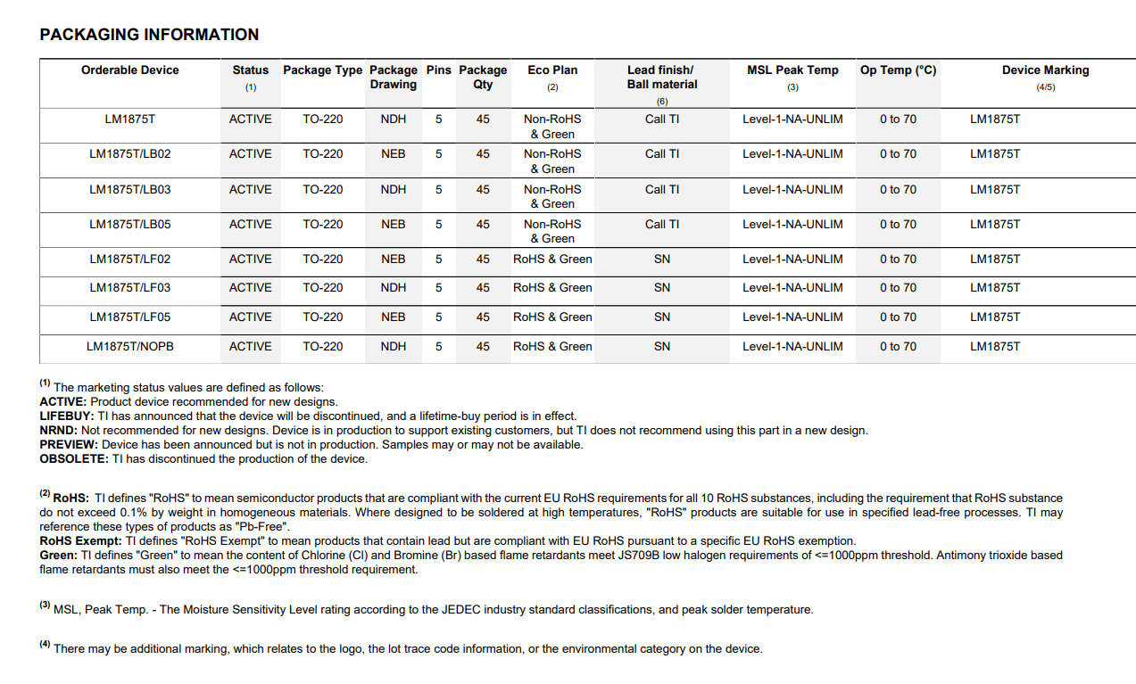

(The meaning of the terms is in the datasheet.)
Thanks, I did not read far enough to see the packaging addendum.

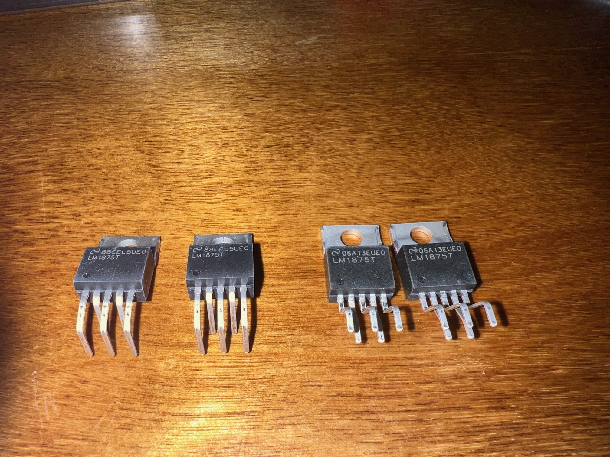

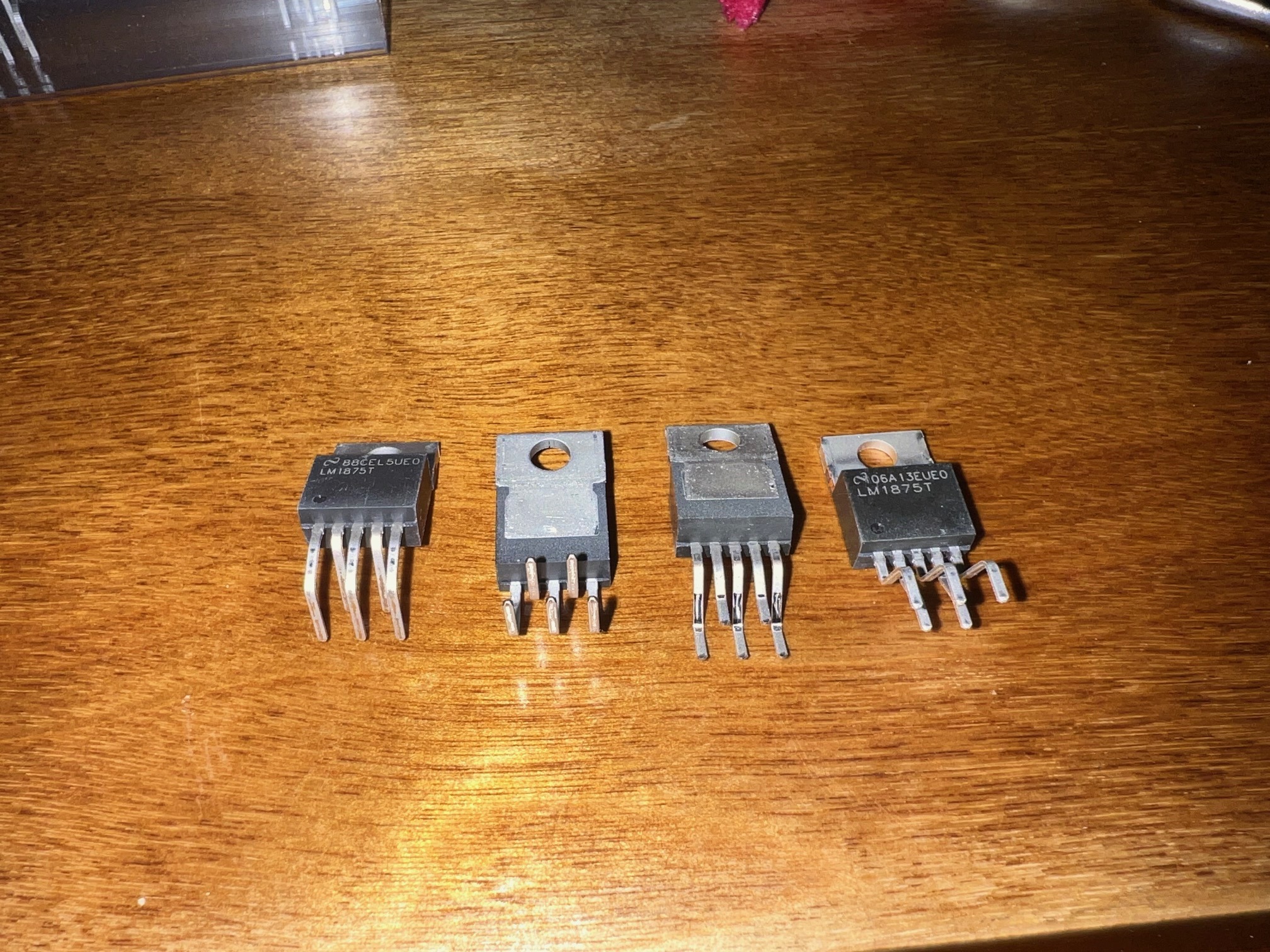

So if the chip is laid on it's back:
Mouser sometimes shows the pins not bent but you can't buy them that way.
That is the main thing I was looking for.
However, I could not find the LF and LB suffixes on the TI terminology page. I wonder what is the package with no suffix.
- NDH .. the bent pins are pointing up
- NEB .. the bent pins are pointing down

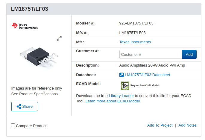

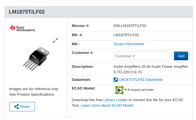

Took another look at LM1875T packaging info and the mouser part images.
I wanted the /LF03 (NDH) but ordered /LB03 which costs $1 more.
- /LBxx are designated life-time buy. They are not-Green and cost more than the /LFxx
- /LFxx (not sure what "xFxx") stands for. They are Green.
- /xx03 and is the popular NDH package. They are on order.
- /xx02 I think it is for flat mounting on a PCB. Maybe on a heat spreader
- /xx05 sames as /xx02 but costs 10 cents more.
- mouser shows the /xx03 image correctly but shows the /xx02-05 as "other?"

Lots of suppliers say 'images are for reference only...' and are often inaccurate in the detail for specific parts. They may even show a different part entirely as long as the package is about right.
