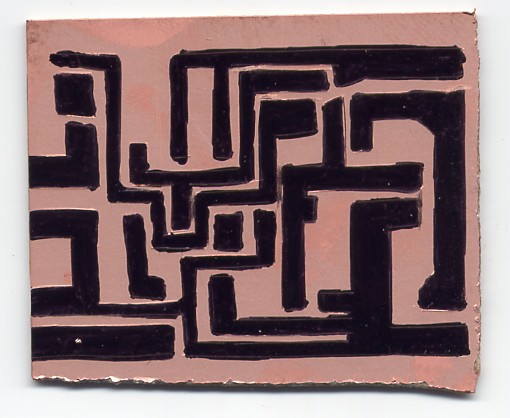

i'm building am amp using the lm1875, and wanted to know which pcb to use. The National datasheet gives two pcb's one for plit supply and one for single, what does single and split mean, and which one do i use for 5 channels?

single supply applications require only one side of a supply...BUT u have to use at least 12V if u're aiming for +/-12V originally...split supply means u use a centre tap rafo or a dual sec trafo and produce +/- voltages...a spilt supply system will require slightly less parts...

Thank you very much li_gangyi, that really makes sense and i can't beleive that i did not figure it out myself. Thanks for the help now it's time to go make some pcb's. I'd like to post some pics of thm when they are finished.

Next time I would advise you to use a different technique for your prototypes, instead of a felt pen.
Use translucid tape to cover all the copper, then carbon copy your pcb design onto it. Then use a razor blade or surgeon knife to cut the tape away following your pcb design and exposing the copper.
Then dip it in the acid.
It's quite easy and gets good looking results. It's good for just a few boards, or it will get tiresome.

no pcb point-to-point
It ain't really a gainclone with a PCB. Try soldering directly to the chip legs. Its easy and follows the Gaincard philosophy of shortest possible signal paths...(not sure I believe that though). But anyway the making of a PCB is a roadblock you do not need with the very few components required in a minimized gainclone. Just solder!

actually i did cut the traces out with an exacto. But then just colored inside the lines. When you say to use tape do you mean leave it on while in the ferric chloride? If that works with the tape on it will be a huge timesaver. Also my pcb's are mirrored, so i must surface mount the components, not a big deal. Thanks for the help.

It works, it plays and it's my first amp. It buzzes a little but there is so much info on how to stop that in the forums that it should be a simple fix.
