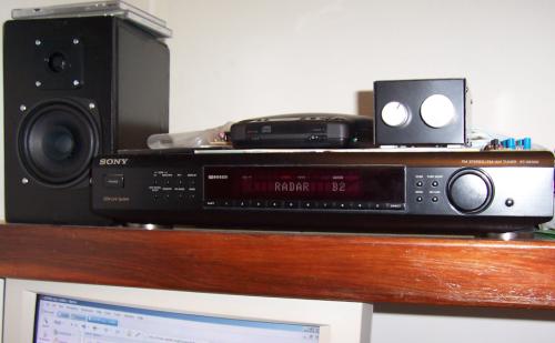

paulmac said:If you want simple, and it's only for the lounge room, go for the LM1875. With only five pins, it's hard to stuff it up. Just make sure you have a nice power supply reserve behind it, something like CarlosFM's "snubberised" setup, and you'll be fine.
I always liked the LM1875 very much.
That's what I use on my bench, always listening to it.
LM1875 + snubberized PSU.
I have tested this amp on my main system, with my difficult Epos ES11 speakers and I could not believe... it drives them quite well.
Also, it's small, I can take it everywhere.
It made quite a success on this year's new year's day party, with an old Philips portable multibit CDP (tweaked) and a pair of (tweaked) Boston speakers I have.
Who wants to make a small, simple amp should try these chips.
Beware, you can end up with a (low power) high-end amp.

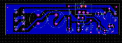

Hi Angel-Baby,
Here's my PCB layout for lm1875,i hope you'll like it.By the way there's one important point on layout.There's one hard to see SMD resistor between IC pins 4 and 2 as a feedback/gain resistor that directly soldered to pins.But if you don't have any SMD you can use conventional resistor in the same place because there is a enough space in that area.

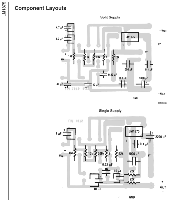

I am building an amp with LM1875s and I'd like to get the best sound quality possible. I've made one some time ago using the data sheet's schematic, but I guess there's a better way.
Michal.

For a lower supply like +-15V a gain of 10 would be good
Around 1 Vrms input would give maximum power peaks.
For schematic the recommended standard circuit from National datasheet would work best.
Reason?
Because National want their chips to work good and become popular
So, if they would NOT publish optimal standard circuit,
they would not act in there own interest of selling many chips.
Customers staisfied = Best advertising
We should not have any doubts, that this standard circuit has been carefully tested
in very advanced electronical laboratory with test personel with high education/knowledge
and that have testing gears we DIY members can only dream of
Such a big company as world leading National Semiconductors
does not pick amateurs of the streeet when selecting their technical staff.
They can afford to handpick only the best.
This is why you should FIRST consider the standard circut.
From this you can make small adjustments, if your system have some special need.
Also for PCB study the recommended PCB layout for LM1875.
and not without careful consideration and testing
Let us not fool our selves too much, in thinking we know better than best qualified people.
After all, they do this for their profession. With the experience that comes from years.
Some DIY members here are good.
But I do not for one minute think
that National handpicked laboratory personel is inferior in any aspect of Audio electronics.

Attachment.
LM1875 PCB layout.
note: Should be mirrored, as is shown from component side.
Small layout is good, especially when you're making hundreds of thousands it can reduce cost, but for a hobbyist there can be other concerns and small size really does not matter if you have a ground plane. Remember that besides the feedback loop, or power rail decoupling, other signal path distances are already going across wires many times as long as a centimeter saved or lost.
