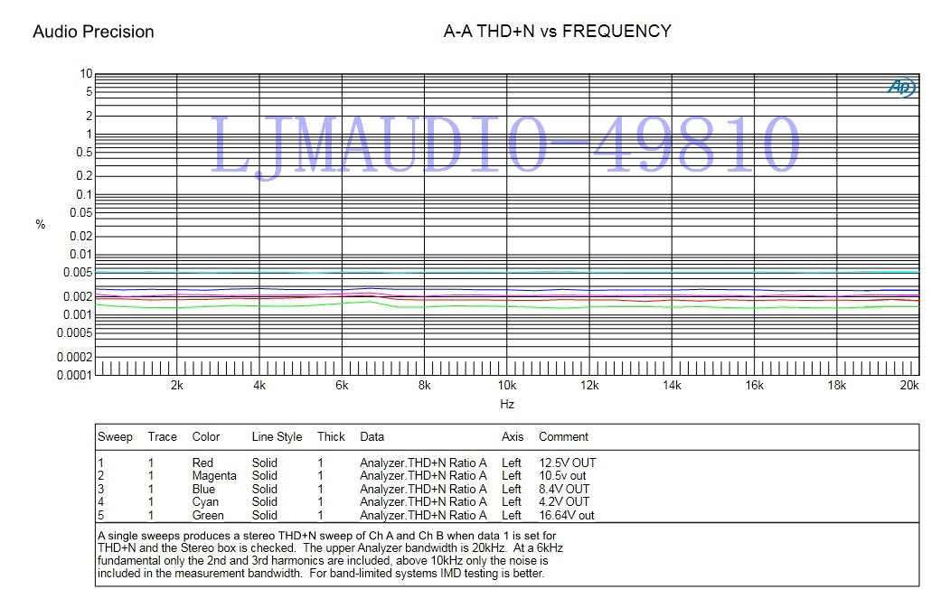

Well, that depends. If your PCB layout is good, you can beat the performance of the stock LM3886 with the LME49810. However, if you screw up your PCB layout, and it doesn't take much to do, you will not be able to beat the data sheet performance of the LM3886, at least not on THD+N. In particular the output nodes (drivers, Vbe multiplier, compensation pin) are sensitive nodes on the LME498xx ICs.
Do you have any measurements of how your circuit performs? THD+N vs output power and THD+N vs frequency, for example?

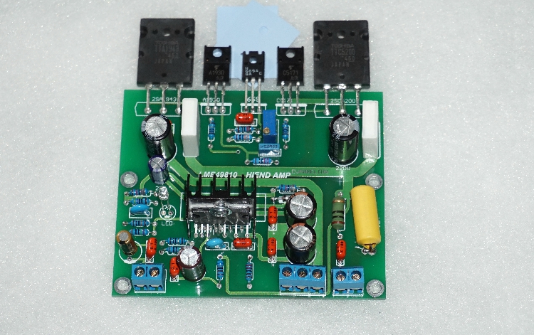

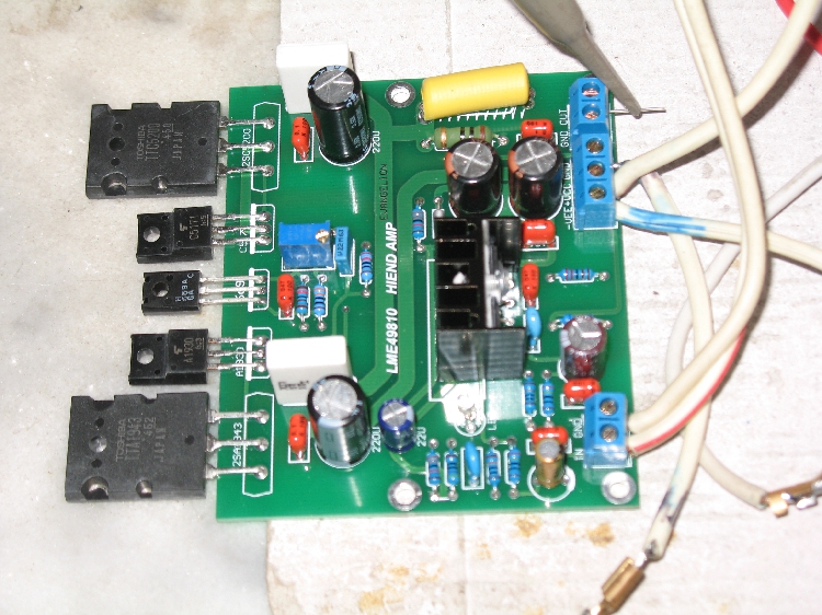

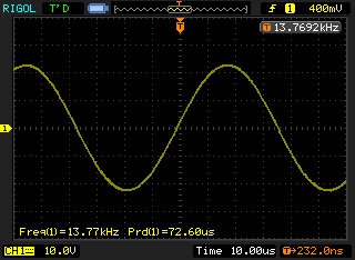

LME49810 + A1930 C5171 + A1943 C5200
Power can easily do 150 w eight ohms.
I don't need to beat LM3886. Because they are not comparable.
And I would like to add, even more low THD, also is not to say that beat this.
An amplifier THD is less than 0.02%, THD is no longer important.
A powerful, low impedance amplifier at the time of use. Damping coefficient difference effect is very obvious

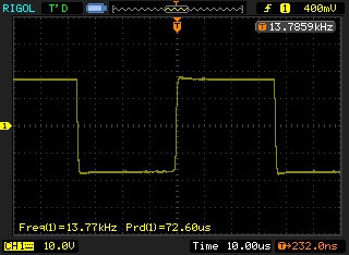

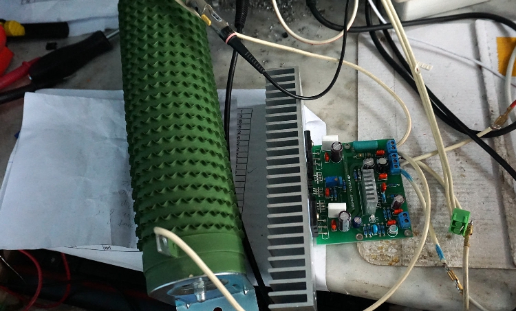

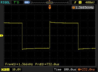

I'll use the oscilloscope measurement. It can be seen that the amplifier is normal and stable.

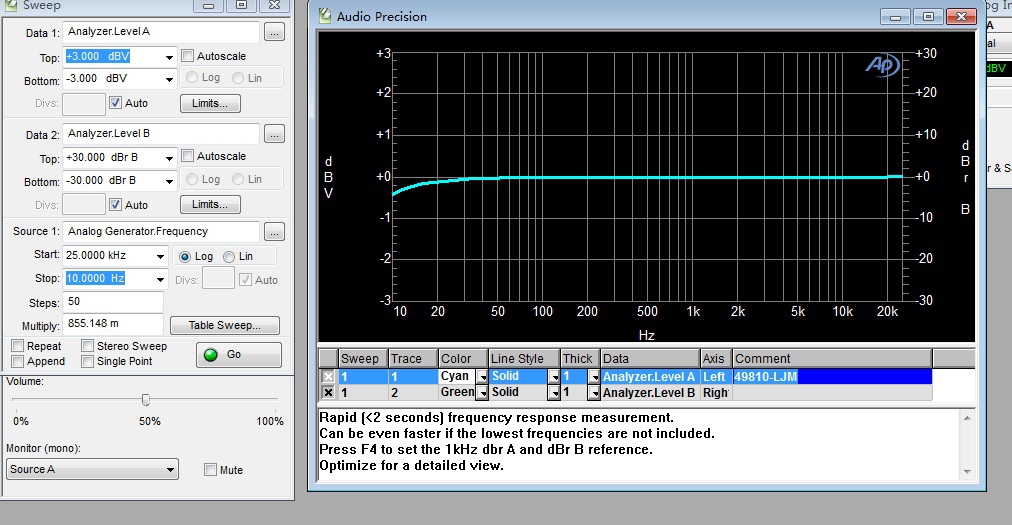

Then I would have taken the time to use APSYSTEM 2 all parameters measured.
I'm not interested in doing the smallest THD.
I only responsible for all kinds of information on it.
In the actual test, THD are slightly larger than the PDF.
I think that is normal.
By electrolytic capacitor, the effects of input capacitance. MKP might be better.
The influence of the power supply.
In actual production, very fine material, even the conductor can produce distortion of 0.0005%
I also tried different relay, distortion can be increased 0.0002%.
I don't believe anyone do THD is less than the PDF. Including LM3886
