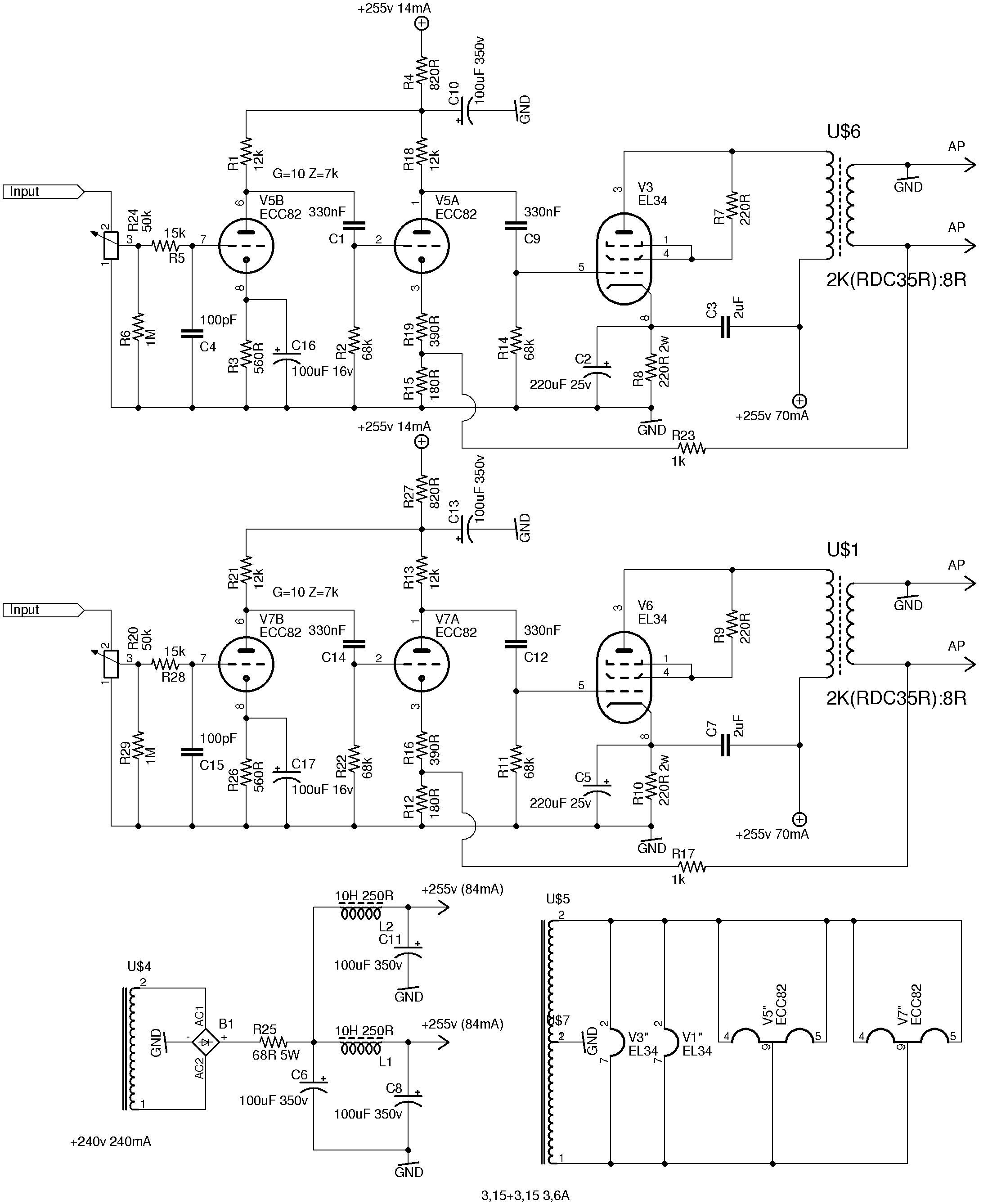

OK here is the schematic (hope you can see it)it is not mine but courtesy of sm lab.
However consider that I had to modify the power supply because I had two transformer available in house one for the HV and the second one usable as said for the heaters. All the rest is the same apart....
yes I have to confess that because of money I could not efforts to buy decent TU so I give a try with two toroid transformers I had in house obviously connected by using and inductor in parallel and a condenser in series in order to avoid saturation. Now you know all the story and blame me if you wish but it works and works well (for me). Don't forget that this was an exercise for me I must also say that I am the first to be surprised by the results.

Wouldn't a valve change i.e. replace the 12AU7 with one you propose require further adjustment to the schema? As said I am new to the business therefore not much capable in re design stages while the guy that made it is very skilled. Ref why the feedback goes on the second stage not sure but again the guy that made it must have his reasons
I could increase the gain reducing the feed back but in that case distortion would be higher?
I forget to mention that at moment the EL34 are connected in pentode mode not in triode as per schema

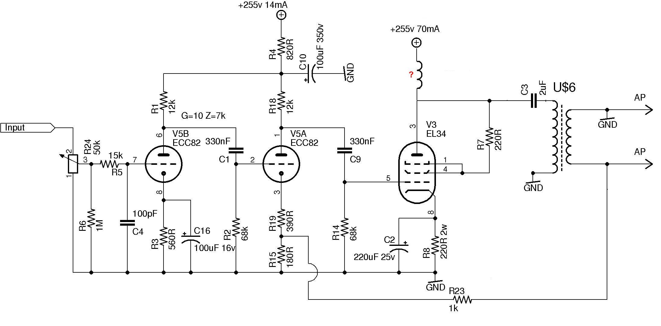

Do you mean like this? What is the spec for the toroid? And what are the values for the coupling capacitor and inductor?
Yes just I did connect the capacitor ends between the output of the inductor and the transformer not between the output of the inductor and the tube as per yours (just move it a bit on the right side -))
Value are 20H for the inductor which I believe is to reduce noise and 4.7uF for the capacitor
Spec for the transformer is 220/12v 100VA for an estimated output load of 8 Homs
This is also from an other guy more skilled than me that help

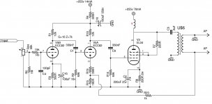

Yup, I made a stupid mistake drawing it up, I corrected it now... Actually, nothing wrong with the way you did it, in fact, it is commonly referred to as the parafeed or parallel-feed connection. Is the 4.7uF non-polarized? What happens when you remove the negative feedback (1k), does the amp still oscillate at full volume? Be careful, it may get very loud.
Jazbo
Why do they feed the global nfb to the driver and not the voltage amp in the beginning?
May be just one less stage to deal with, so a bit more stable. I suspect the oscillation at full volume might be due to the non-spec toroid OPT...

The coupling capacitor should really be non-polarized, so it has to be replaced eventually. The no feedback test is just to verify that the amplifier is perfectly stable without feedback - it should be.
To lower the hum, I think you can lower the 26V supply to 24V with some resistors, to me that's less important, first, you should make sure the amplifier is completely stable at full output, even if you are not likely to listen to music at that level.
