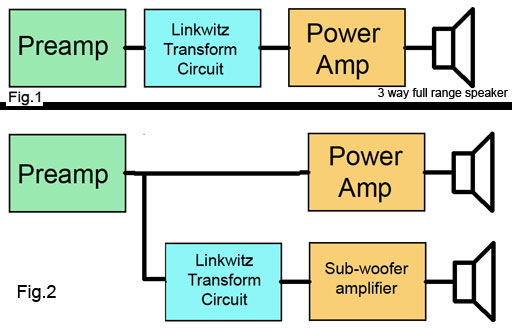

Figure 2 needs a high pass filter on the high end and a low pass filter on the low end, otherwise is appropriate. I'd put the low pass after the LT to help kill any HF noise generated by the LT.
fig 1 is ok, not sure what setup your representing in fig 2
Thank you for the help, Ctrlx.
I will build the circuit and report you back about my experience.
Thank you so much Bob for this helpful and very clear guidance.

I have built this active crossover circuit following this source :

and this is being used in my current active amplifier setup comprising 6 X LM3886TF chips.
So, do I still need Linkwitz Transform circuit in my 3 way active amplifier setup? or will it be redundant in this case?
That all depends on what you are trying to achieve. Remember that Linkwitz-Reilly filters are different than a Linkwitz transform. Both have their place.
If you are doing a standard 3 way and don't need to extend the woofer response, no. A two way plus sealed sub, maybe you want a Linkwitz Transform.
As with most things the Linkwitz Transform isn't a panacea. It can extend the response of a driver but only if the driver has the excursion and power handling to accept the transform and you have enough power.
So, I respond to your question with a question. What are your design goals and what drivers do you have in mind?
Just caught the 6 x LM3886TF. Unless you are looking for a low volume system, you won't have the power for a significant Linkwitz transform. If your transform has just 10 dB of gain, your top end will be limited to 6W to avoid clipping the bottom end.

Agree, except I would extend that to cover any type of X-over not properly dimesioned for a given system, whether active or passive.
Also, and I really want to stress this point based on many years of experience working with the common "Linkwitz transform" circuit, it's definately not a panacea or miracle worker. I found that in general, F(3) of most designs can be lowered an octave at most if the drivers X-max and power limits aren't exceeded, and the amp being use can supply the power, but in the vast magority of cases, less than an extra octave can be obtained before difficulties set in.

Thank you Bob, your answer is very much appreciated! Very nice clarification.That all depends on what you are trying to achieve. Remember that Linkwitz-Reilly filters are different than a Linkwitz transform. Both have their place.
Oh okay. I am planning to use a ported enclosure here as on Rod Elliot's site I read earlier that LT can be used in a ported enclosure too in some cases, if I am not mistaken.If you are doing a standard 3 way and don't need to extend the woofer response, no. A two way plus sealed sub, maybe you want a Linkwitz Transform.
Since I do not have access to world class driver yet, I want to experiment with my current DIY 3 way active system with what is available in my situation, for the time being, using a ported sub-enclosure in my man cave. I have already built the enclosures by obtaining TSP of the drivers and tuned with Eq-ing using pink noise and so far sounds pretty good. Still I want to know/learn from all of you on how to get more out of it, if possible.As with most things the Linkwitz Transform isn't a panacea. It can extend the response of a driver but only if the driver has the excursion and power handling to accept the transform and you have enough power.
Thank you again for this very informative and much needed reply. My system is a low volume one in a near field listening environment.
