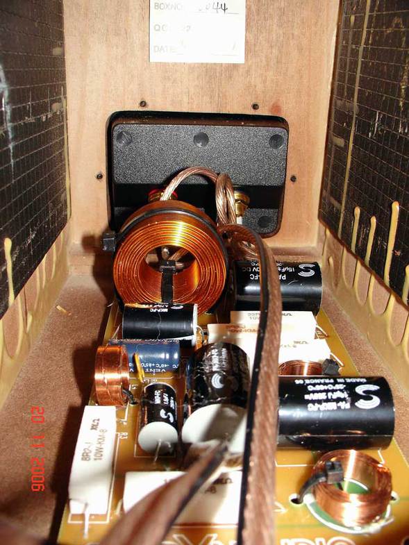

http://www.diyaudio.com/forums/multi-way/223174-interesting-read-i-found-lossy-cabinet-designs-harbeth.html#post3234256
You then can add panel damping of some sort, sometimes bitumen, sometimes rubbery stuff, like in this Harbeth ply construction.

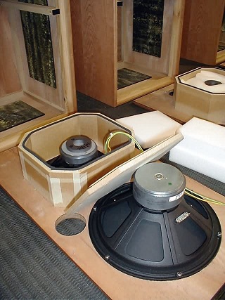

It would be wise to search 'constrained layer damping'. This is an effective technique with a few good simple choices.
Why not do both. Not to oversimplify the issue but the bracing is effective in dealing with the lowest frequency box resonance where the panels all move together. The panel damping deals also with higher frequency issues. The stimulus for each is slightly different and each can be its own problem.4392Viper said:I guess what you referred to is more of "bracing" rather than "lining".

Stiffness is more effectively addressed by bracing, mass doesn't do much and the loudest noise from the cabinet is almost certain to come from the cabinet walls resonating. What reduces resonances is effective damping. Constrained layer damping is possibly the most effective DIYable damping and consists of gluing a layer of stiff rubbery material and then a constraining layer such as another layer of plywood half as thick as the load carrying layer.
